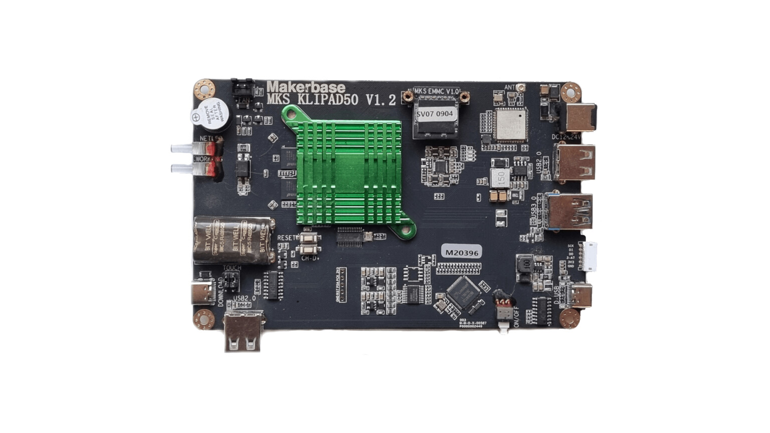

Something I discovered on accidentâŚ
The board will 100% boot and run if you plug into the hidden USB-C port labeled âDOWNLOADâ.
You have to open the case to access it. A phone charger works fine. I was going to mod my case to use it but decided to open a support ticket instead.
Do you think that would fix my problem?
It wonât âfixâ anything. It might get you printing while you wait for a new board.

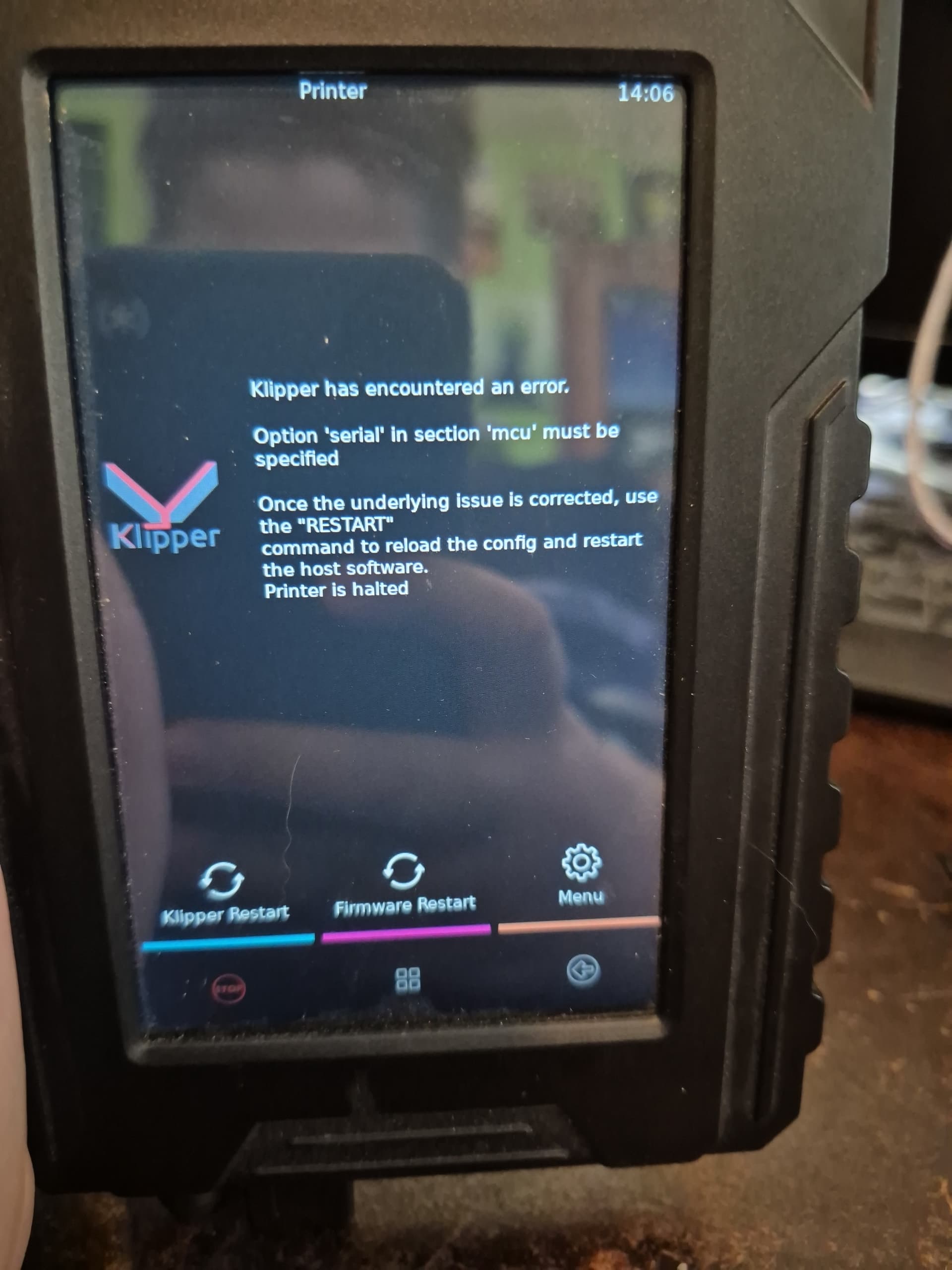

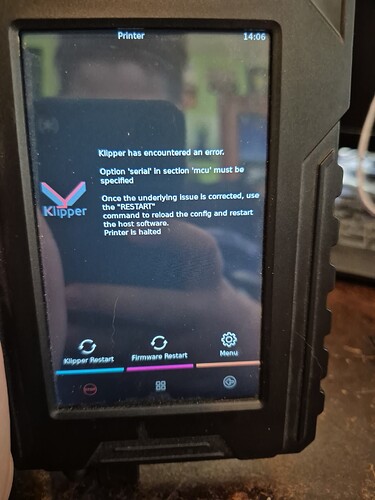

Sp I sent an email to sovol explaining the problem but right after I did that my printer gave me this screen after changing nothing
So:
- Armbian is booted
- Klippy service is running
- Moonraker is running
- KlipperScreen is loaded and connected to Klippy via Moonraker.
Almost home. It seems the version of printer.cfg loaded on your Klipad isnât correct.
The easiest way to fix it is via Moonfaker or Fluid.
Do you have Orca Slicer configured to connect to the printer over WiFi? Does it connect now?

Yes try powering it with the USB-C. I could never make a data connection with that port but it will run the board and display.

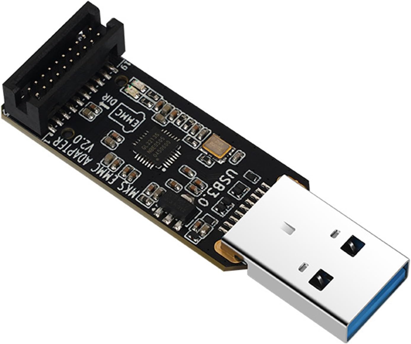

Ya Iâm still waiting an a response from sovol I did some digging and it looks like I could use this to wipe the drive and put the OS back on it
