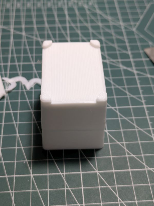

Did the same thing again at the same place. When it’s filling in the feet it just goes off the model. Also, I did tighten the front knob.
https://www.dropbox.com/scl/fi/8vo2d7xk71qslj7gsk6il/1x1-Cube-pirnt-with-support-brim.JPG?rlkey=n8g4x27ue7qq6h94sdgimpi26&st=5le5om2h&dl=0
I’m not sure if this is normal, but when the extruder is moving around it will make a loud noise like gears grinding.

Ok. Definitely not any foam blocks left. The bed manually moves smoothly back and forth consistently along the whole travel. It was in the process of layering the four feet, going from one foot to the next, when the head suddenly jumped out a couple of inches to the front of the bed and layed down the two extra feet you see in the pic.
Lion, since you were able to print this, and I am trying to print exactly the same .3mf, it would appear that I’ve got a hardware problem. Sounds like a manufacturing problem since it sounds like you all have seen this before. What would be the best way to contact SOVOL?

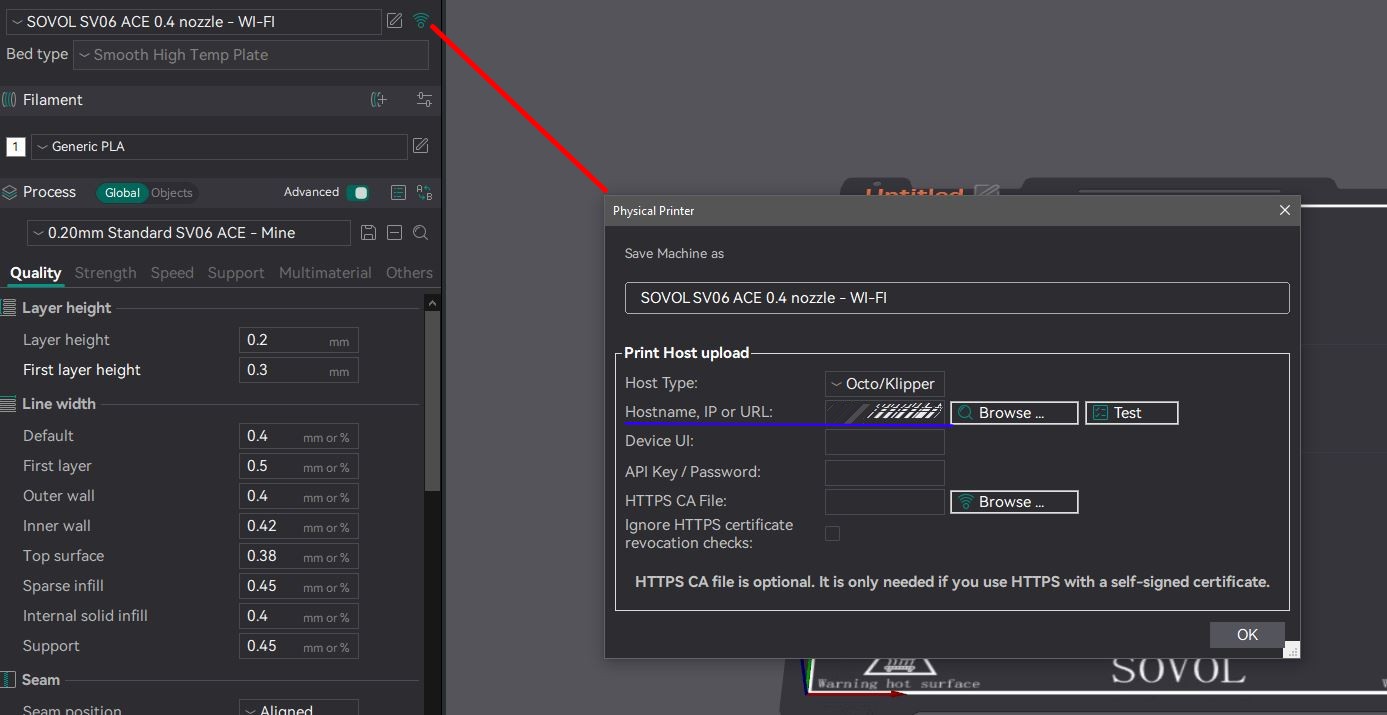

Once the ACE is connected to Wi-Fi…
You either have to use the IP in a browser window or enter the IP into Orca.
