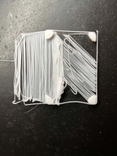

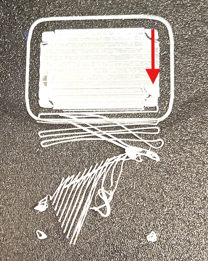

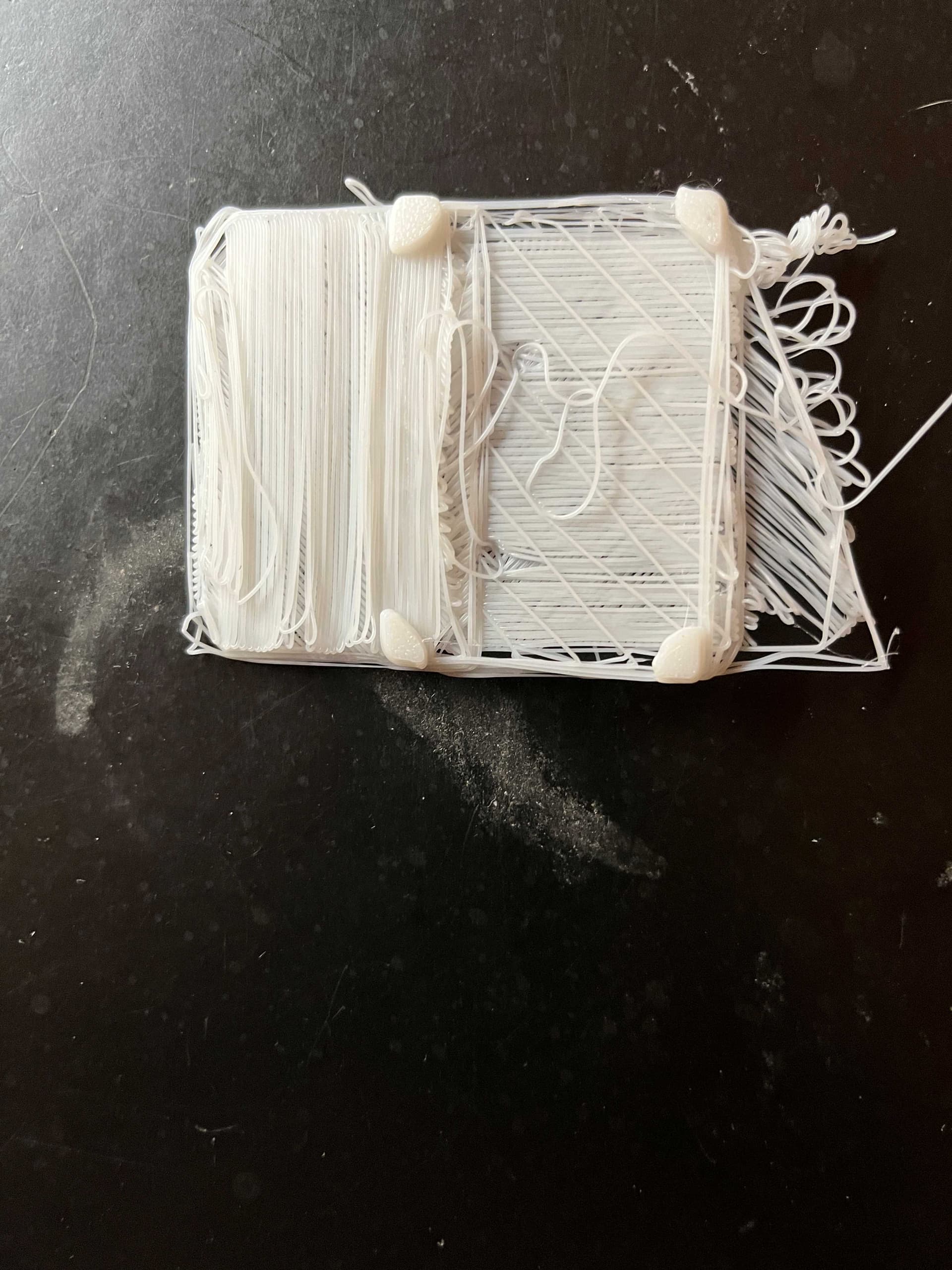

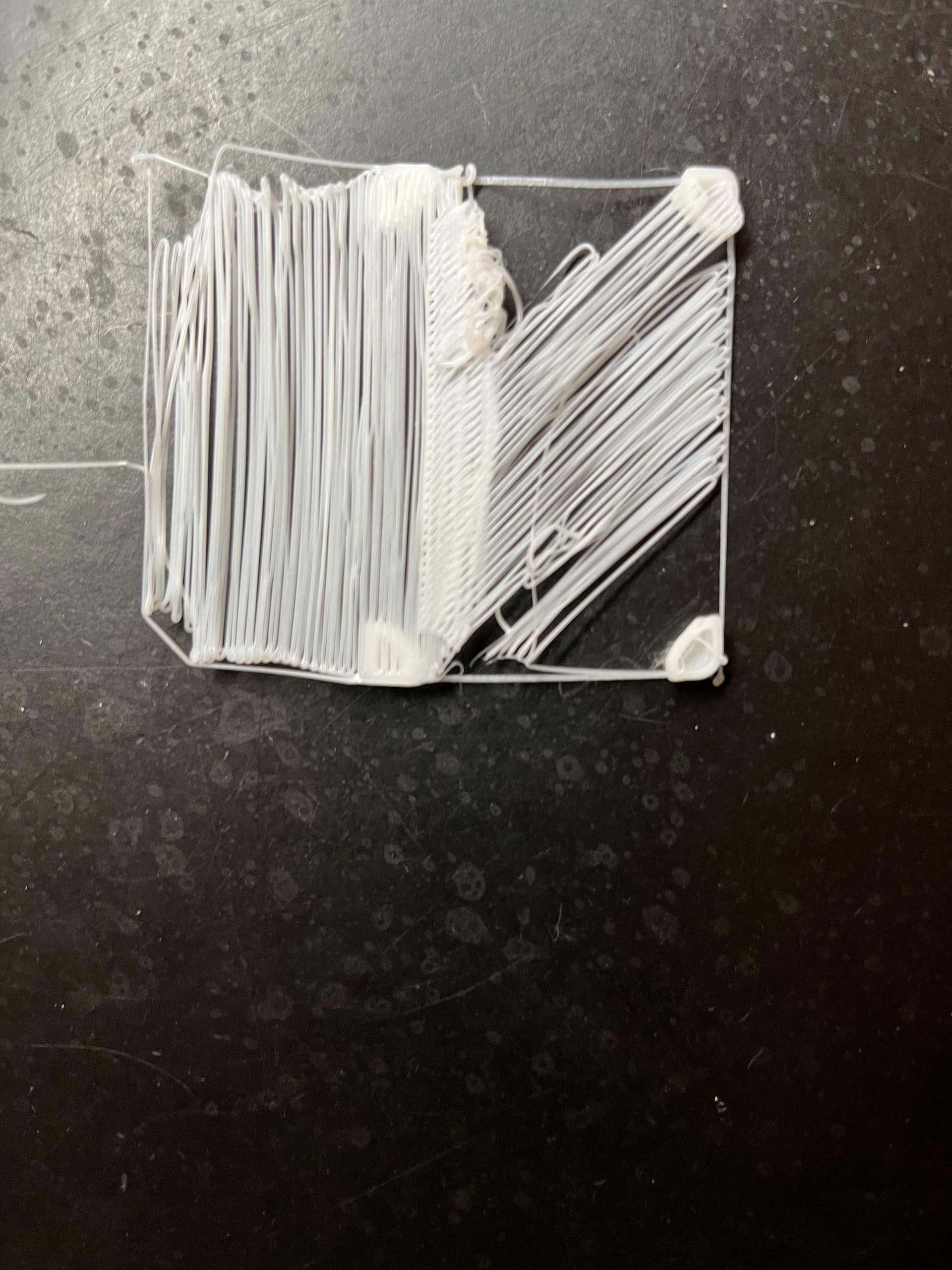

I just purchased a SOVOL SV06 ACE from Amazon and am unable to print anything. The printer Firmware is v19 and I am using Orca Slicer 2.3.0. I am attaching the STL and GCode files for a small storage bin as well as pictures of the results of two unsuccessful tries. It is not even printing out the correct shape. At this point I have no idea what to do and am ready to return the printer.

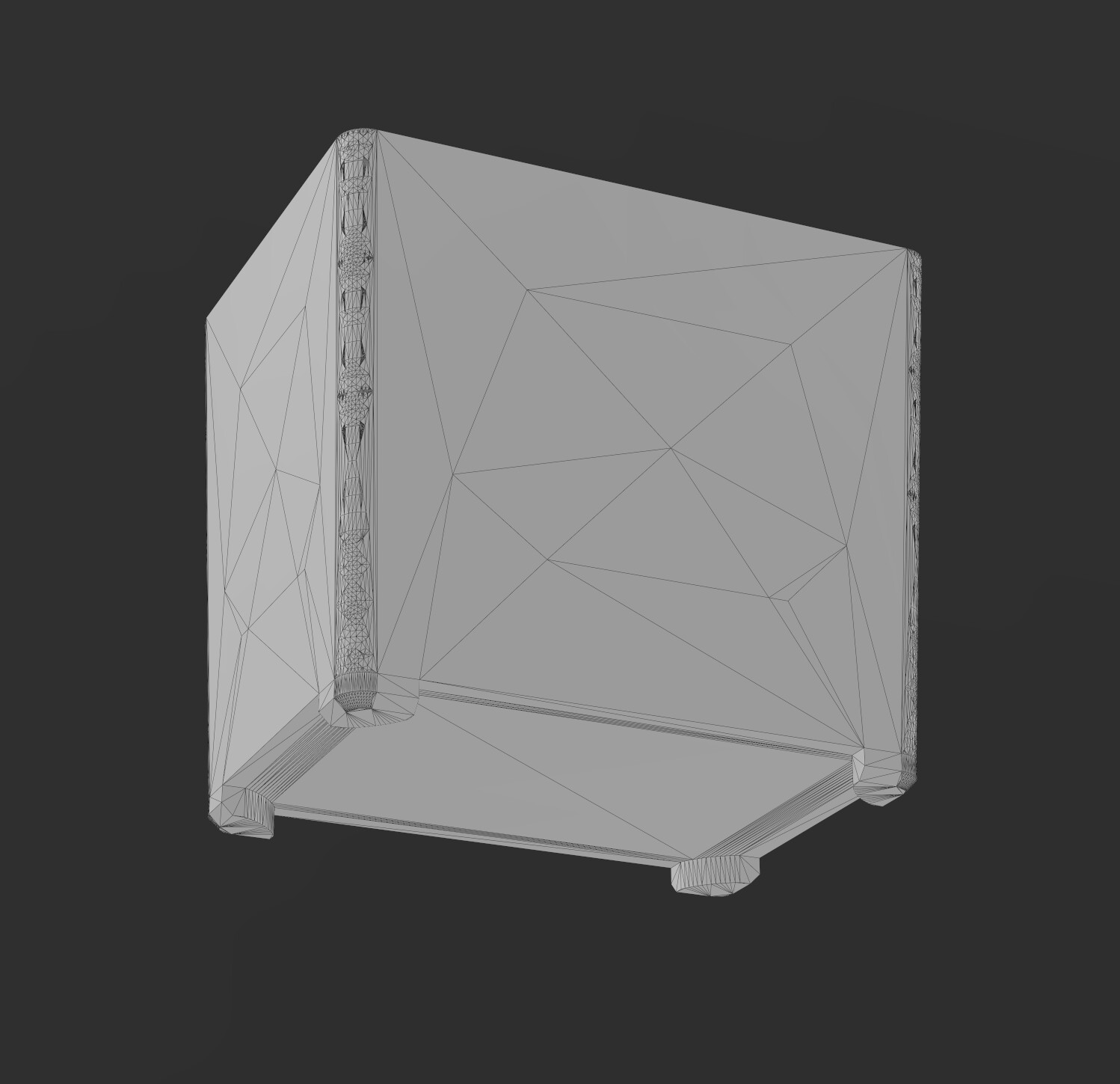

Here are your pictures…
To me it looks like your printing on the magnetic bed & not the plate.
I say this because I don’t see the PEI surface.
I’m not seeing this:
If I’m wrong can you show a full view of the entire print area.

Sorry, the black background is not the plate; it’s my desk mat. I put a copy of the plate in with the rest of the pictures.
Your model is VERY difficult for an FDM printer unless you rotate it to print on its side or enable supports
Try an actual cube or maybe a benchy.
I just loaded this into Orca and sliced it without supports and was going to screenshot the errors.
Only problem is, Orca sliced it without warnings. BUT it still is going to require an extremely well tuned printer and filament profile to print bridges on top of bridges to get the bottom printed

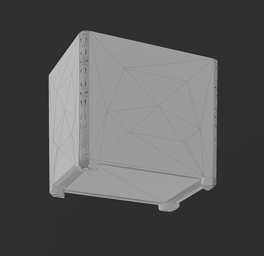

They also included the .STL of the model.

As you can see from the pictures, the print is not collapsing, it’s just printing what appears to be a side in the wrong place, on the bed next to the bottom.

Your photos show the little square legs are working. The printer is trying to bridge from leg to leg but those are not adhering to the legs and are getting pushed to the side by the next layer.

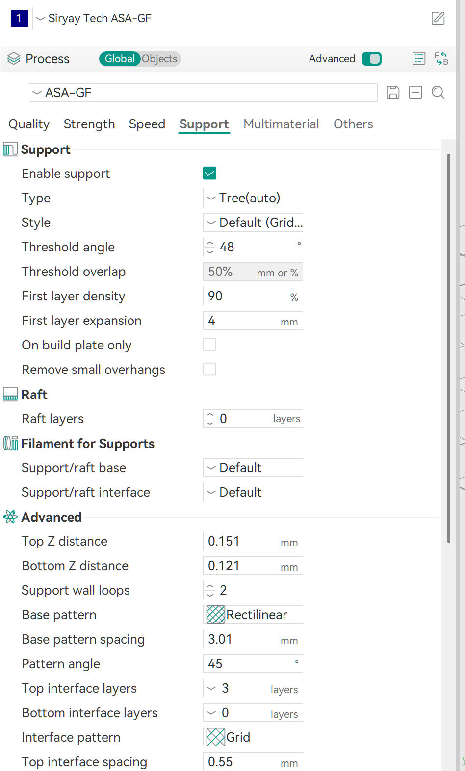

There is an entire tab in Orca for supports.

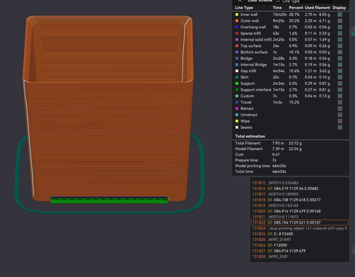

Load this file in Orca & try to print it.
The Green part in the pic are supports, you will have to remove them (trash) either by sliding a spatula between the model & support or just breaking them off.

It’s a bug in the Orca Profiles from Sovol, don’t worry about it.

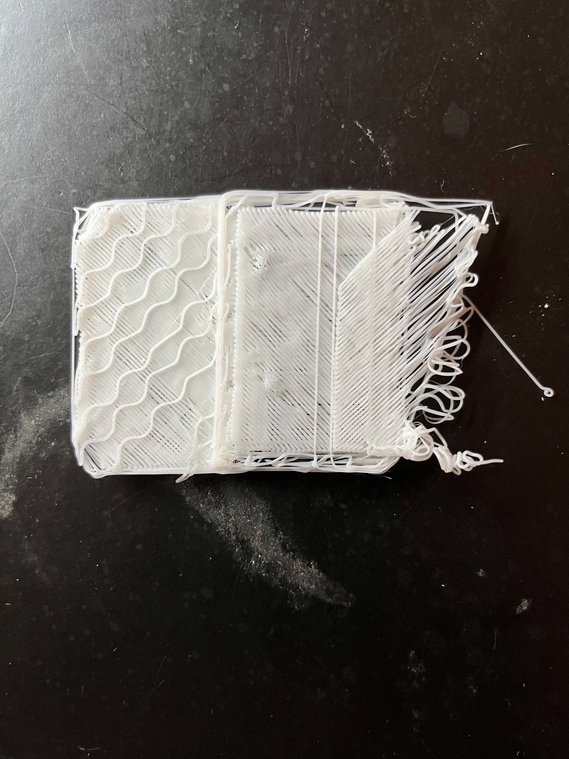

Ok not much luck. Here’s the link to the pic.

Looks like a huge Y offset.
The foot for layer 5 or 6 is 15mm from the layer below.
Knob at the front tightens the Y axis belt. Make sure it is snug. If that doesn’t solve it check the grub (set) screws in the belt sprocket on the Y axis motor (at rear of printer in line with front knob)
