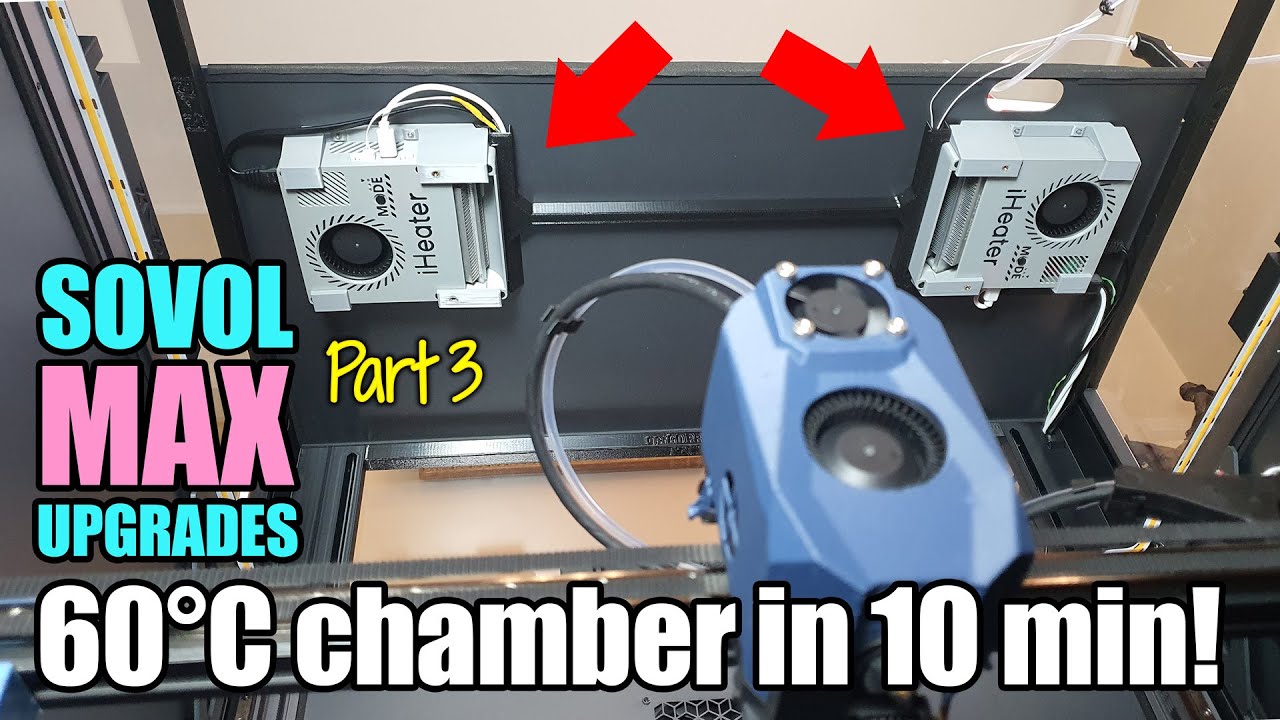

yea i picked this up second hand as the original guy gave up with al the issues . i have it dialed in pretty good for now . but they also claim there a chamber heater but i have yet to see it . i have the enclosure at the moment but no heater … .weird . looking at the mother board pin out i don’t even see an option for an additional heater or temp probe and the ui dosent seam to support it either..
The heater is an “add on”. Look at printer.cfg you’ll find

Note The second line is commented out. Looking at chamber_hot.cfg you’ll find it has it’s own MCU
[mcu hot_mcu]
canbus_uuid: 58a72bb93aa4
The chamber heater is not currently available to buy.
where can i get the heater? do you have a link? i did find the config so thank you for that!!!
It’s a DIY kit. Link is in the description for the video.
Watch the video as the build/installation/configuration process is somewhat complex.
It is NOT a plug and play solution.
Also: If you live in the US an additional 400w load May trip your breaker if all the heaters go 100% at the same time.

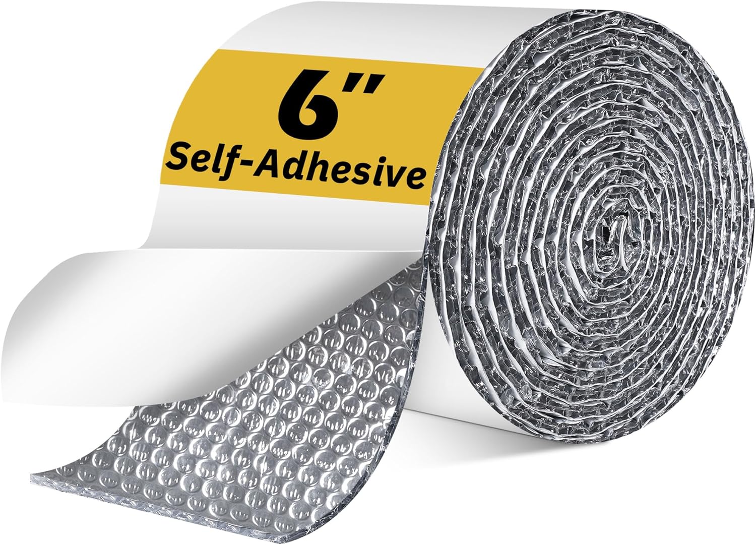

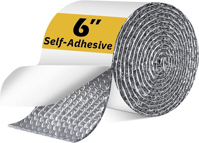

How hot do you want it? I simply insulated the metal walls and chamber temps are in the mid-50’s printing ABS just relying on the bed heat alone. One needs to heatsoak the bed anyway, by the time that’s done the chamber is warmed up too.
What material did you use to insulate the walls?
Could you please provide a link to where you sourced it from ?
Thanks in advance
The link to their build guide is in @torch’s post above.
It seems to me that a product with adhesive backing would be easier than spray glue.
