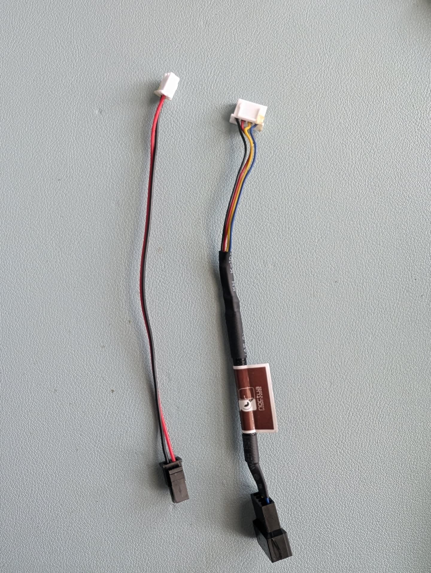

I just did that, actually. Sacrificed the two 4010s that were in there for their fan connectors to make adapters. One for the Noctua over the AC bed heater, and the other to a connector for a line that will run to a Nevermore filter once I build an enclosure extension.
hey, you dont by any chance remember the wiring for the 4 pin jst to molex for the Noctua fan for the bed heater mosfets. Saves me having to work it out lol.
Cheers
Oh man, if I remember right it was straight across matching (you can almost see it in the picture). I just tested with a multimeter. Sorry!

No worries, thanks, ill have a lock next time i have the printer on its side. lol
