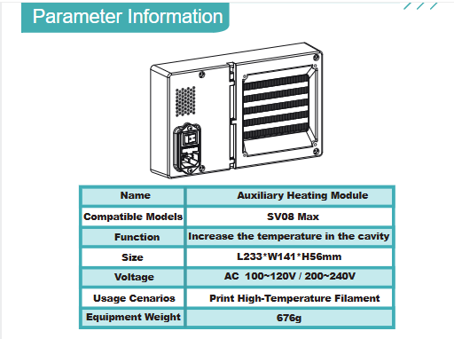

That’s really great, but is there a bit more information about the device? I can’t figure out where it is supposed to be attached. And a bit of tech spec (like heating, power consumption) would also be highly appreciated.
Ok, that’s a start. I gather it’s dual voltage? What is the wattage and current draw for each? How does it mount? Does it replace the input case fan or is it mounted somewhere else? Does it come with a thermistor? Does it plug into the MCU for Klipper control?
