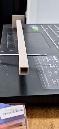

made a pair of these shades in this cape coddy blue/gray,. and they finished
now not purty, to be clear. Without the fuzzy skin those goobers would look like ,… more clearly defined goobers. But, I have a spot for 4 and thought this bone(polyterra mutedwhite) would mix/match well.
3 fails, all well past halfway, one came loose, then 10~20 layers later the second(2 on the plate caddycorner)
grabbed this Z test in 3 heights off the orange site.
added the 8mm hole…
anyway, I had been enjoying some nice first layers on the sv06 with a comgrow double, using the smooth side.
tried one on the +, Its not really 310x320, so tricky to place but big enough and after a quick A4 light tug offset , I sent it and it finished.
I noted a tiny bit of tower wiggle in the last 20 mm or so.
The pics are meh, but there is barely notable VFA, and a random chubby layer here and there
what I did not expect was the bottom when I picked it up as a clean cold release later on.
yea, that stuck for a 300mm elevator ride
