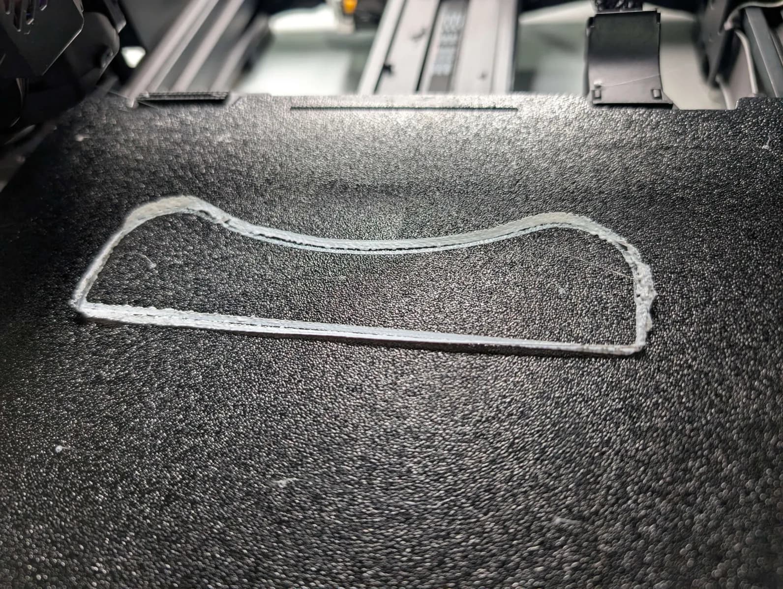

I’m still struggling with first-layer adhesion on my Sovol SV06 Ace, and I’m hoping to get some advice. I’ve tried several adjustments, but I can’t seem to get a consistently good first layer.
:white_check_mark: What I’ve Tried So Far:
:straight_ruler: Bed Leveling – Multiple auto-leveling cycles and careful Z-offset adjustments.
:bar_chart: Probe Accuracy Tests – The probe readings seem reasonable, but the first layer is still inconsistent.
:soap: Bed Surface & Cleaning – I clean the bed regularly and have tried different surfaces (PEI, glass, etc.), but the issue persists.
:control_knobs: Filament Settings – Adjusted flow rate, temperature, and first-layer speed, but no major improvements.
:magnifying_glass_tilted_left: Issue Breakdown
I’m attaching some images to help diagnose the problem:
:chart_decreasing: Probe Accuracy Graph:
(Graph showing probe accuracy results)
:stop_sign: First Layer Problems:
(Photo of the first layer showing the issue)

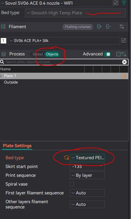

This helped me, it might work for you.
The Ace profile is set to Smooth Plate only.
If you click on Objects, you can change it to Textured Plate.
But, the setting doesn’t hold, you have to re-do it each time you open Orca.
I’m using the latest beta version of OrcaSlicer, which includes support for multiple print beds, and I’ve selected the one you mentioned.
I mentioned it, because unless the Orca Beta changed it, you can’t change plates from the top…it’s shaded out.
Yeah, Orca beta changed It. Now you can change It.
