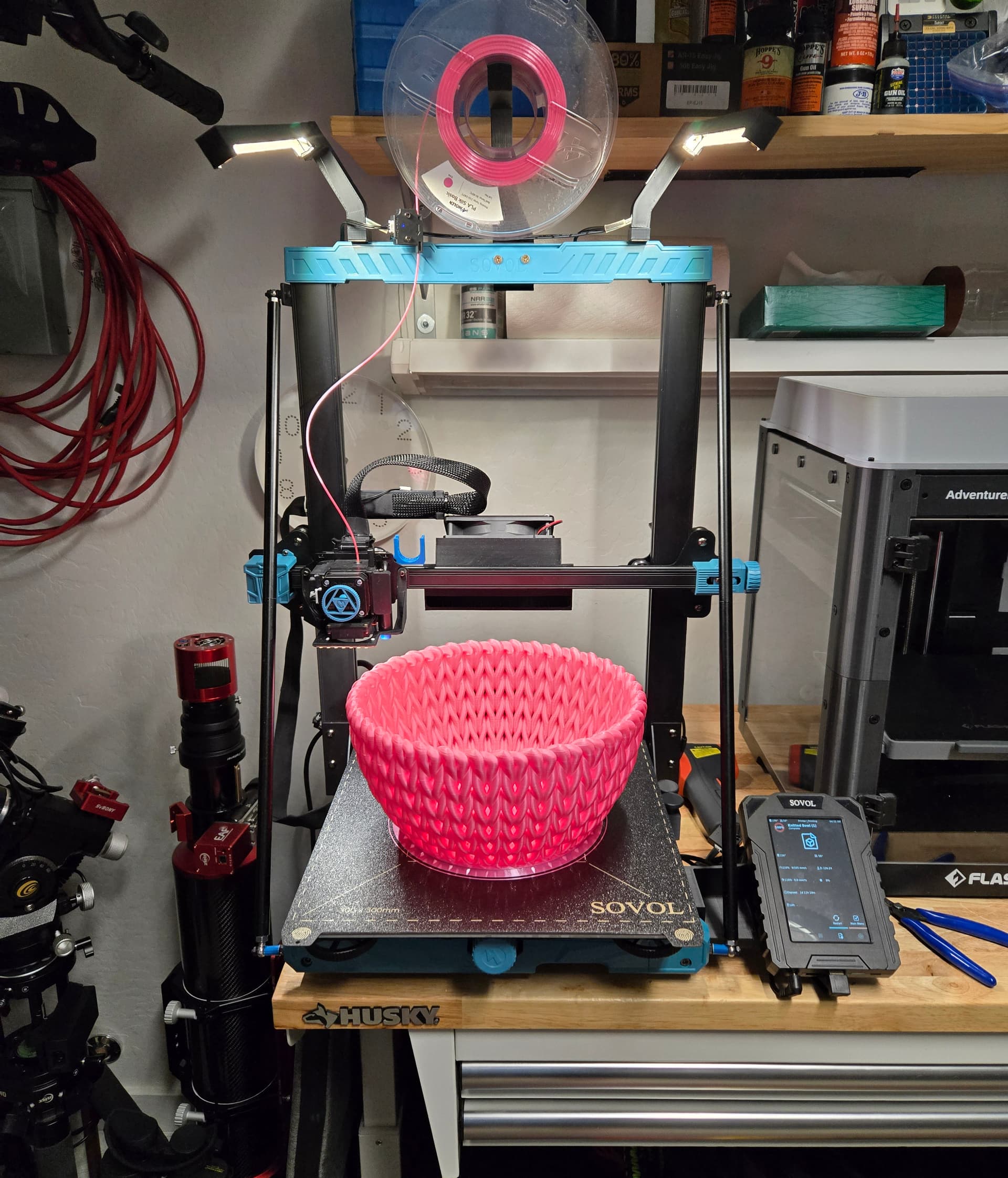

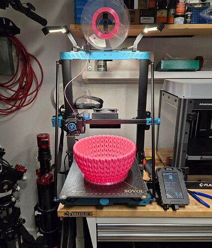

New structural supports at 400 speed a success
Trying out supports to help with the shifting problem as prints get heavier/taller. 2kg of silk pla material for a total run of 36.5 hours. First run is a success, some minor tweaking needed before tackling a full size helmet. 120mm fan conversion is a must, the usual other mods including the bulky extruder cover removal. Prusa spool holder to balance the spool weight on top, new motor brackets, extended console mount and a whole lot of GoGerd videos to help fine tune.
