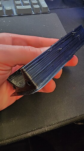

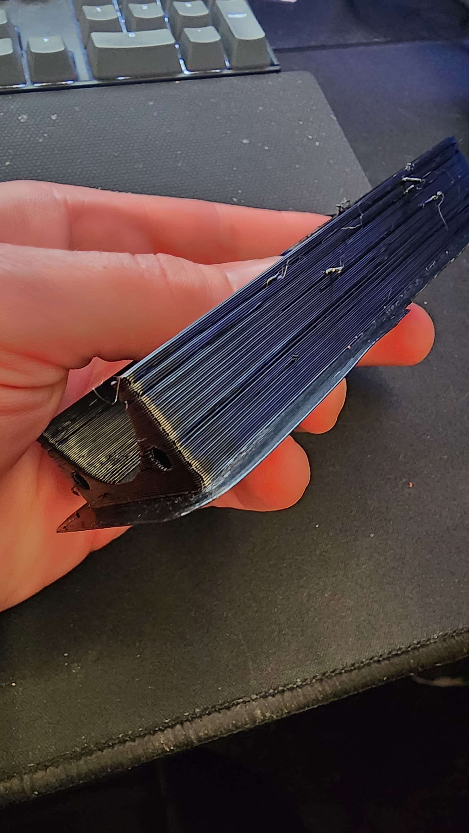

I fix 1 thing and find 3 more things wrong. This did fix my printer but now im having layer adhesion issues, internal sparse infill not printing or adhearing to the print, or stringing of the sparse infill, or blobs of filament all over my print within the first 5 or so layers, nozzle keeps clogging the list seems to be endless and I cant seem to get anything figured out. I have done all of the calibrations on the unit along with the ones in Orca slicer. I get the calibration test to look good then print something with the new settings and its trash. I put on a new spool of filament and have not gotten 1 actual print and have used about 200g of this spool so far with nothing to show for it but my frustrations with this machine. Just cant seem to get any type of win.

2: This is the big bad one, sounds like heat creep.

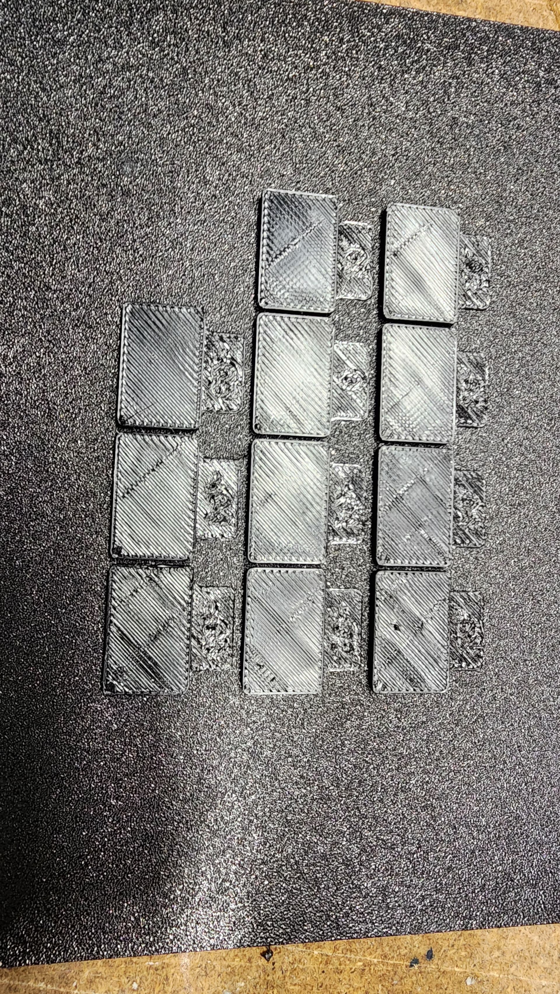

So the plate gets washed and I use 99% iso to clean it after every print. It also doesnt have consistent adhesion issues as it varies from print to print on the same file. First the brim will not stick, then Ill retry and a small spot in the middle of the first slow layer will not stick, so on and so on.

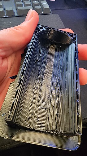

Like right now im trying to figure out why all surfaces have this line going thru the top. This is just a flow test but every print has it.
I thought it might have been the nozzle moving over the print to close and dragging making those lines across the print but heres the print with travel on and the nozzle doesnt go over any of those spots on the top surface. Its almost like its not pushing filament out in the perfect way that it matches line by line looking like a cut across the surface.

From your print, I’d say the Z-Offset is too low, but we’ll get back to that later.

Ive had this printer for over 4 months def not my first print. Never had adhesion issues like this but seem like they are ok now just having issues with walls and lines. Using PETG .6mm nozzle. No worries bring on the questions. LOL
