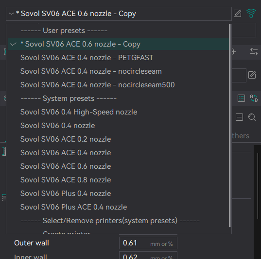

Orca slicer has presets for all the different sizes for the ace
I thought the last Orca update included a .6, but I lost all my settings for the ACE when I added the Zero..so now I have .4 only unless I add them or wait for an update.
