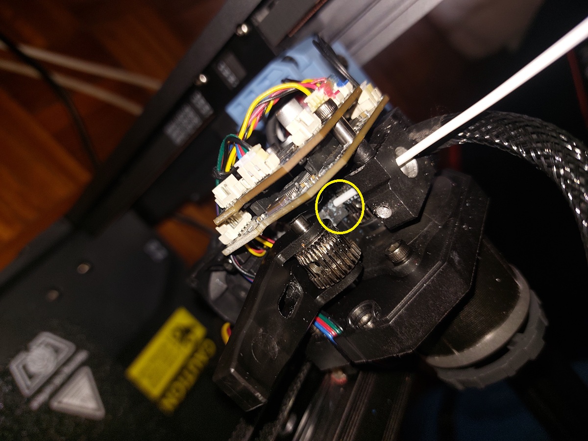

The extruder doesn’t turn with the “load filament” button? The extruder turns on when I press “Load filament” load until check image attached
Does the hot end get hot? Yes
Using the lever to hold the extruder feed rollers apart how far can you manually push in filament? check image attached
The filament goes more or less 10mm more into that part with the yellow circle. I think it gets stuck on the beginning of the hotend just my opinion.
I can do it manually (like the case on the picture), but also if i press “Load filament” on orca.

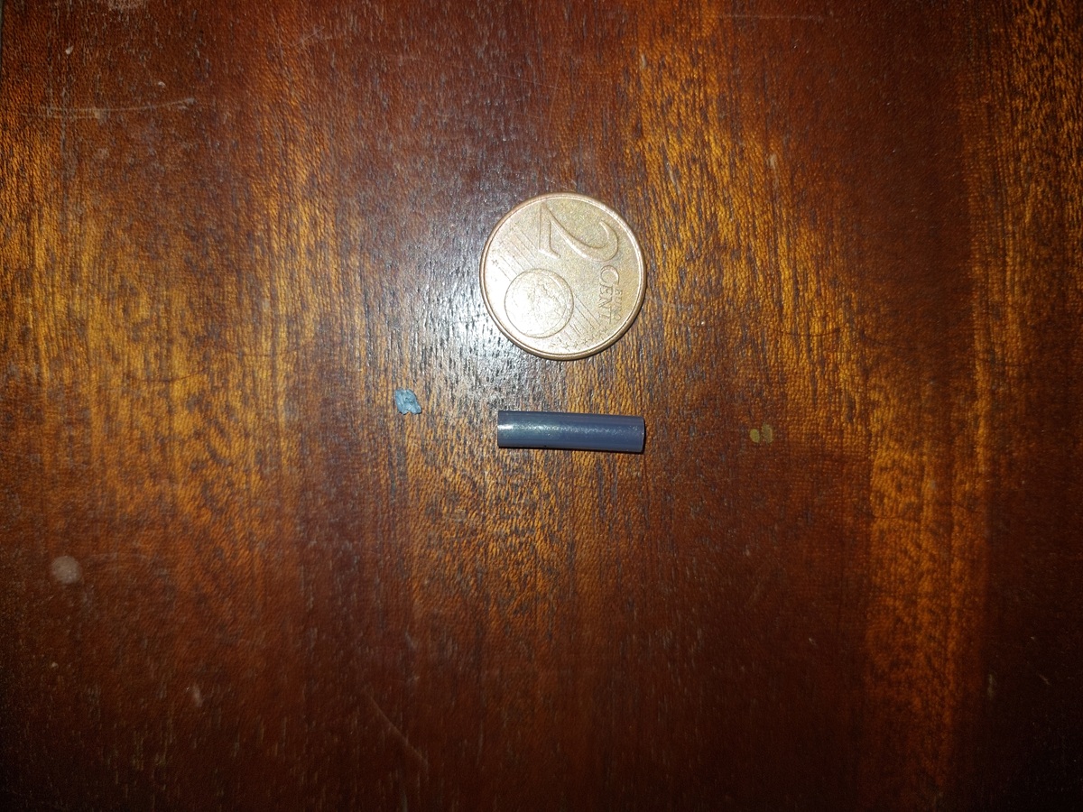

the hot end is brand new unused, virgin :slight_smile: …I will take it out to check if has something on the way of the filament
There was something very tiny on the way, you can check the image on the +/- 10mm tube were that tiny piece of filament…
So it’s working now..??
Yes it’s working fine…testing the Micro-Swiss flowtech hotend…so far so good :slight_smile:
