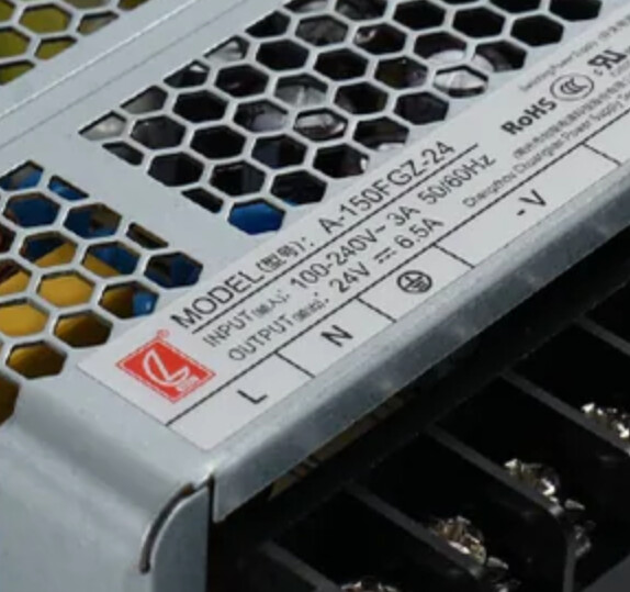

i received and assembled my sv 08 max a few days ago, but the only thing i get after startup is a message ‘‘mcu buffer_mcu : Unable to connect’’ and i am at a loss. i checked all the reachable connectors, unplugged and replugged them, and looked for an input voltage switch (i could not find one, here in germany it would have to be set to 230 v). can anyone pls. get me into the right direction or help me fix this ? thank you all very much in advance
It appears the power supply is “self switching”.
Do you have network connection (wired or wifi) to the printer?
hello, thanks for your reply. ok, the input voltage isn’t causing the problem, then.
yes, the printer is connected to ethernet/lan (and i checked the connection with a notebook, dhcp works, internet is available)
