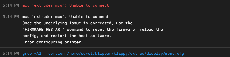

still dead and now theres a new error
Keep commenting lines till no more errors… or the coffee runs out

@KeiffTi - since you now have SSH access, let’s start by figuring out which firmware the printer thinks is currently installed. For that’s you’ll want to copypaste the following command and hit enter:
grep -A2 __version /home/sovol/klipper/klippy/extras/display/menu.cfg
That should produce three lines that you should reply here. In case there’s a No such file or directory error, that also will tell us something. Assuming it was the firmware upgrade which you interrupted, the reply will most likely contain name: 1.4.7. If not then I’d assume it would be name: 1.3.7.
Since the screenshots suggest the firmware is out of sync between components, the fix should be to flash it again and this time not interrupt anything. This too can be forced from the command line and due to how the firmware packages have been structure, that will also overwrite any possibly corrupted files without touching the operating system. The necessary commands are the following:
