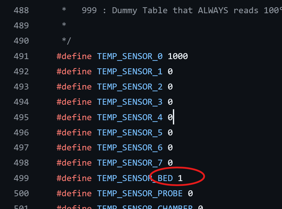

Digging into the source code for the SV06 shows that it uses
A “type 1” bed sensor which converts to a
*  Analog Thermistors - 4.7kΩ pullup - Normal
 *     1 : 100kΩ  EPCOS - Best choice for EPCOS thermistors
 *   331 : 100kΩ  Same as #1, but 3.3V scaled for MEGA
 *   332 : 100kΩ  Same as #1, but 3.3V scaled for DUE
 *     2 : 200kΩ  ATC Semitec 204GT-2
Generic 100K thermisistor. The only source I could find for a complete kit is Direct from Prusa
They have several kits, find one with the wire length and motherboard connector closest to yours.
I’d try a new thermistor first.
