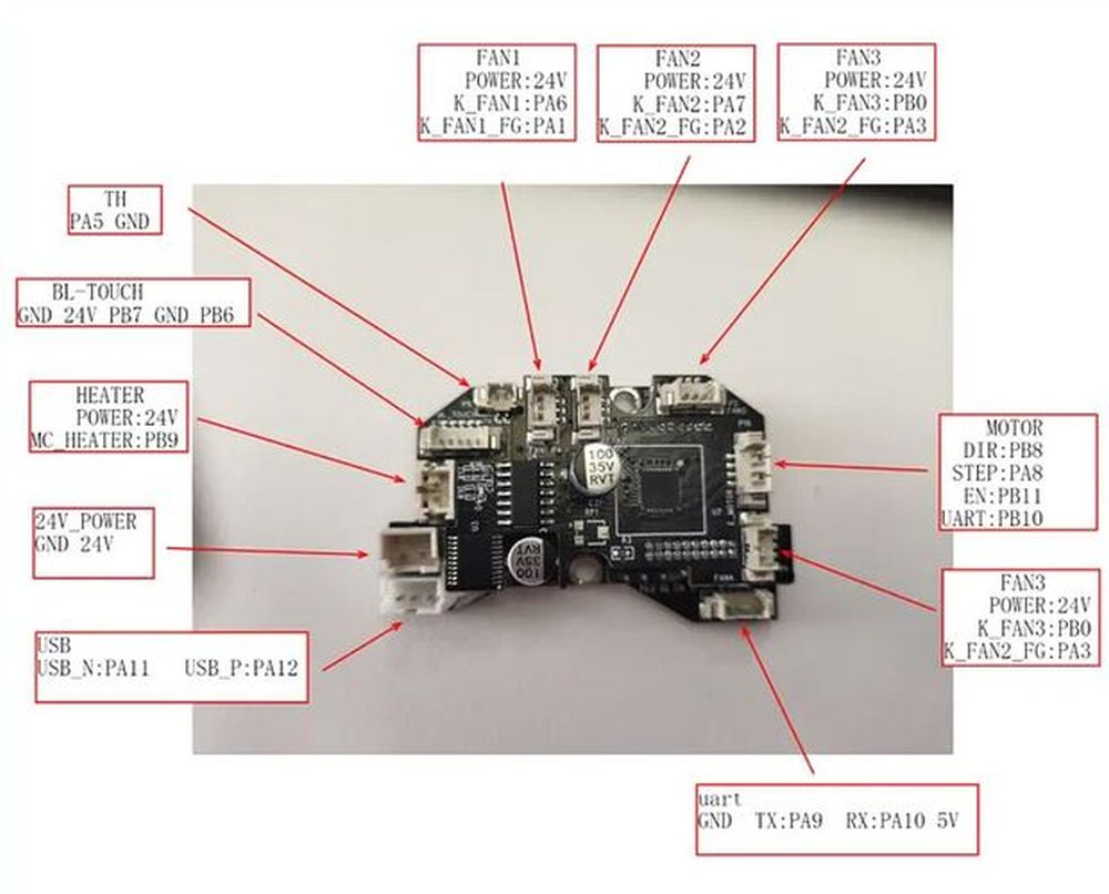

Check the motor wires (4 pin connector) at the toolhead board.
You could even try plugging in your old motor if you can make the wires reach.
I plugged in the old and the new motor-no reaction on both motors…
All the other actions are running.
It sounds if if your new toolhead has a bad board that isn’t able to run the motor.

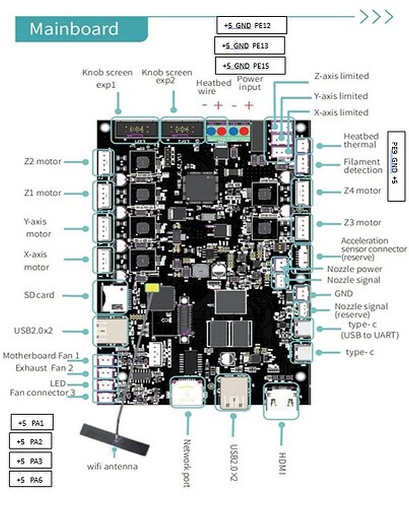

Another question. On which pin is the motor connected to the motherboard? I can"t find any information about the location of the connection pin. Y,Y,Z axis are shown on the Sovo Mainboard “map”, but there is no information regarding E-Motor…
Here’s the extra MCU pinouts https://canada1.discourse-cdn.com/flex030/uploads/sovolforum/original/2X/b/b8131f9010f7639c8ca9a2dce31d390a5e621cbb.jpeg
Unless you messed with the motherboard, I wouldn’t think this would be the issue.

I mean the plug on the motherboard on the bottom of the printer. here are a lot of plugs but where is the extruder motor connected?
The extruder motor connects to the extra MCU in the tool head. The MCU communicates with the extra MCU via usb
The board in the toolhead is a separate MCU
[mcu extra_mcu]
serial: /dev/ttyACM0
restart_method: command
The extruder motor pins should be addressed as:
[extruder]
step_pin: extra_mcu:PA8
dir_pin: extra_mcu:PB8
enable_pin:!extra_mcu: PB11
[tmc2209 extruder]
uart_pin: extra_mcu:PB10
interpolate: True
run_current: 0.8
hold_current: 0.8
uart_address:3
sense_resistor: 0.150
