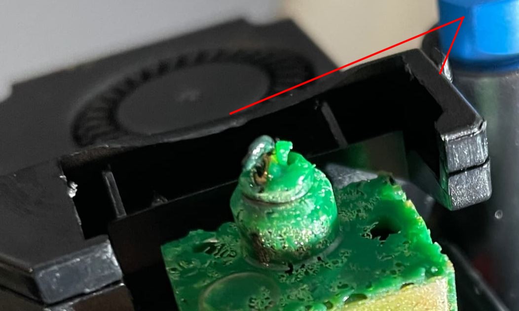

The nozzle of my printer clogged. Upon closer inspection there was a lot of “leakage” of filament around the nozzle housing so I took the hood off to take a closer look and it looks terrible.
Is this something that can be cleaned or do I need a new extruder assembly?
Also, what are some possible causes so I can try to avoid this in the future?

It is fixable…
set the extruder on the plate & just plug in the hotend & heat it up to around 260* , let it sit for about 20 min & then start pulling off the filament with tweezers.
It did have a sock on it. This was under the sock.
It was PLA filament.
To confirm, don’t re-assemble but lay it on the plate?
You can re-attach it if your more comfortable…
but it will be harder for you to see everything you have to remove.
EDIT: You will have to replace the fan shroud or print a new one, it looks like it has been cut away.
Hmm. I don’t know what a fan shroud is. I removed the entire unit from the machine. The only thing I took off was the rubber sock around the whole thing.
Could a missing fan shroud have caused the problem?

This looked like it was cut, if you didn’t, then it’s fine.
EDIT: I just pulled mine to look at it, yours is fine…there is no damage to the duct.
