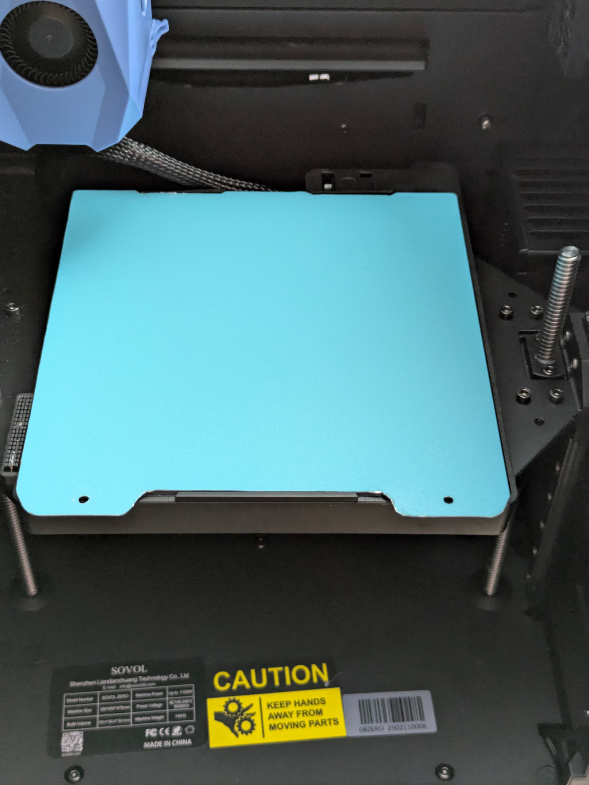

I’ve been thinking of cutting my Glacier plate down to fit the Zero.
Don’t you think the surface will peel off when you cut the plate?
Turned out pretty good. Calibrating right now, will do a test print later today.

What tool do you use to make such a cut?
I started with a Drermal & a Diamond Wheel…
but ended up using & big pair of Tin Snips my neighbor had. This worked out great.
I used the Drermal & a few sanding disks to smooth it out & round the corners.

Just trace it out with a sharpie and use a Dremel with cutoff wheel to get it close then file for fit. It also doesn’t have to be perfect and only takes 15 minutes once you get cutting.

It’s not that easy to cut a Glacier Biqu plate with a Dremel.
The backside is almost clean.
But the frontside, where the cutout is, is in very poor condition.
Use a sanding drum to clean up the edges & print with the bad side down.
That’s exactly what I did.
The cut line was really bad and wide in places, so I couldn’t remove all the marks.
I did my best.
The far edges look a little rough, but I’d say you’ll rarely use that area and it will be after you’ve already worn out the other side. My 1st looked kind of like this but the 2nd I kept cooler so it didn’t melt off as much of the coating. I also have the Dremel flex attachment which probably makes it a little easier. You did it though!!
