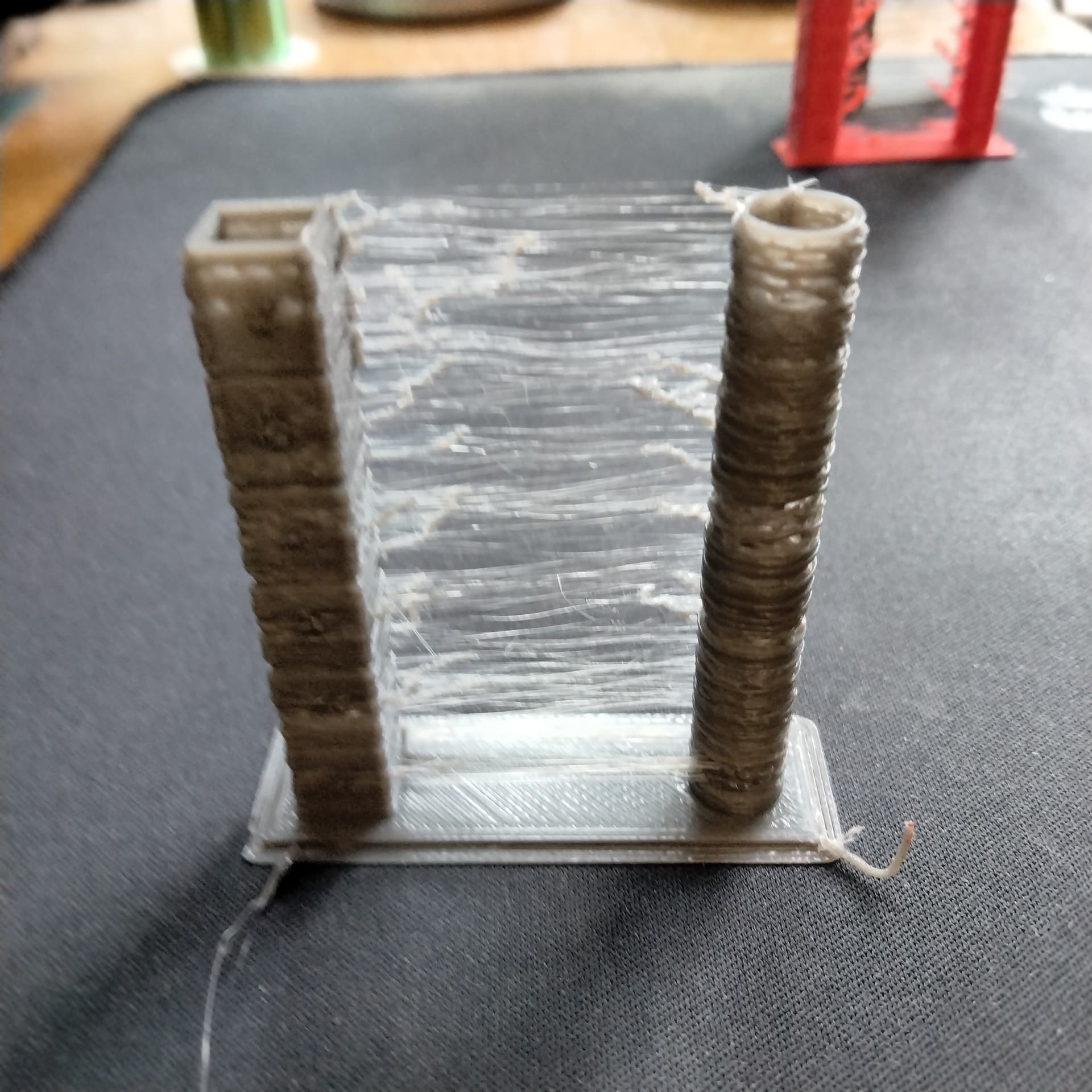

Yesterday i was thinking progress had been made. The temp tower that I posted was encouraging, so just as I said I would, I tried retraction towers again. As you can see- NO PROGRESS.
Temperature was set at 195C which looked the best on the tower. The photos show the results. Retraction towers of 1 to 6 and 4 to 9 both show significant angel hair stringing along with much thicker strings. Also, if the photos are good enough and you look closely, at any retraction settings above 2mm both the right and left vertical towers, are distorted with pitting and illegible numbering. Looking closely at the right, column in places it is so thin you can see light through.
I’ll be out of pocket tomorrow, so maybe I’ll have a revelation as to what’s going on. Along with that, I sure could use your ideas!
Are you printing any models or just calibration models…just curious.

That’s 100% not from stringing.
It looks like a combination of Z-Offset issue (printing too close), ironing & over extrusion (maybe).
Printing to close (Z-Offset) could cause the over extrusion look because it pushes & rips the filament.
