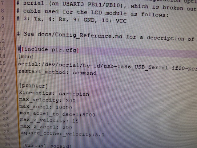

The only thing that remains are a few edits to printer.cfg
I’ve attached one direct from Sovol.
Open the one you are using with notepad and find the line that begins serial:/dev/. copy the line.
Example (yours will be different)
serial:/dev/serial/by-id/usb-1a86_USB_Serial-if00-port0
Open the attached file and delete the line that begins serial:/dev/ then paste in the one from above. Save the file and updoad into the sonic pad.

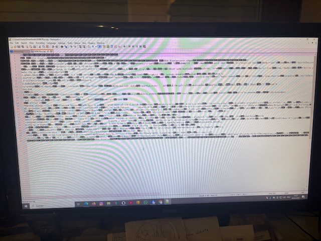

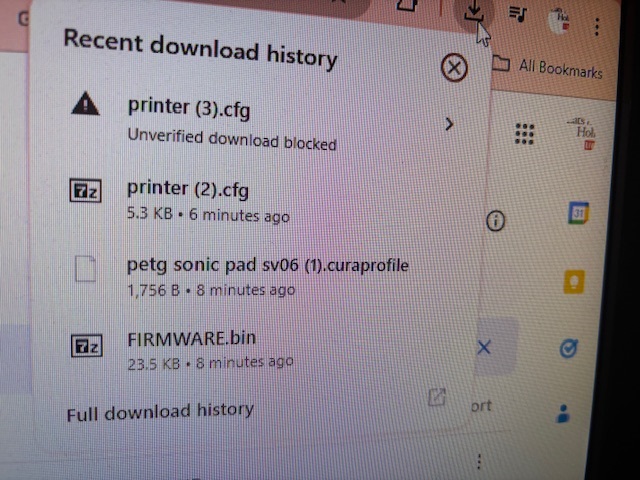

To be honest I dont know how to open it on note pad , yet ! , Im working on that . I seem to have uploaded all you sent me and opend it up with the RAR file opener and the Serial :/dev/ etc was identicle .Hope a grown ups coming to vist me in the morning at talk to me slowly !! I getting the PH2 is not valid etc . again
So my friend , told me over the phone how to download notebook ++ and then put in the SV06 file , did it and got this ! What have I done wrong any clues please

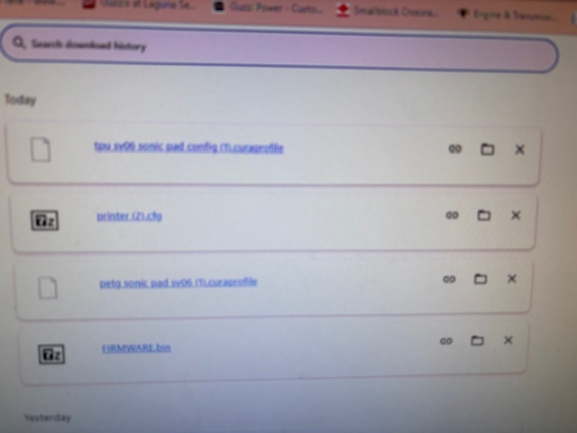

that looks to be the firmware file
You need to edit printer.cfg
Ok here here goes nothing
So nothing new there then !
where is the zip file I sent you?
You don’t need winRAR Windows will open the zip
Doubleclick on the .Zip file. Rightclick on printer.cfg and select “open with notepad”
I get this again
Its opening with zip 7 , does that matter ?
No but it is opening the archive as a text file not the text file INSIDE the archive.
Try this:

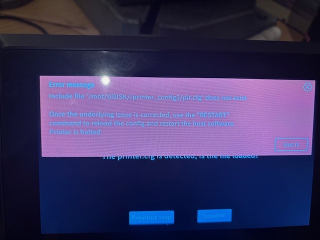

[include plr.cfg]
[mcu]

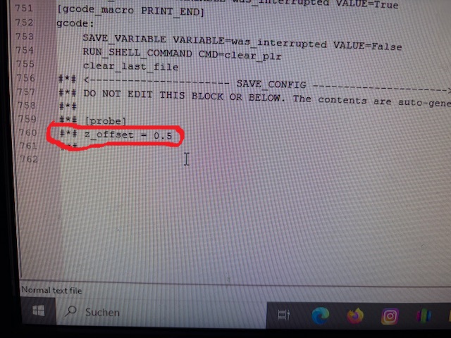

#*# <---------------------- SAVE_CONFIG ---------------------->
#*# DO NOT EDIT THIS BLOCK OR BELOW. The contents are auto-generated.
#*# [probe]
#*# z_offset = 0.5

So I converted the text to note pad then downloaded then this . It looked good at first but I think I have cocked up again !
On your PC edit your printer.cfg file and put a # in front of [include plr.cfg] (near the beginning of the file). Save to a USB and get it into the Sonic Pad.
#[include plr.cfg]
That will stop the error. It will also disable Power Loss Recovery. If that is a problem we’ll come back to that once you can print something.
Have I done it right ?

Photos of your screen are not readable.
It will be better to post screenshot.
It reads, option z_offset in section probe must be specified
this has a #*# in front of it , have I got to alter this , just to one # ?
NO.
Scroll up and find the [Probe] section. You will need to add a line to make it look like
[probe]
pin: PB1
x_offset: 28
y_offset: -20
z_offset: 0
Note this will end up with the nozzle very high until you adjust the Z offset on the Sonic Pad Calibration screen. Klipper will then change the value you have circled automatically.
