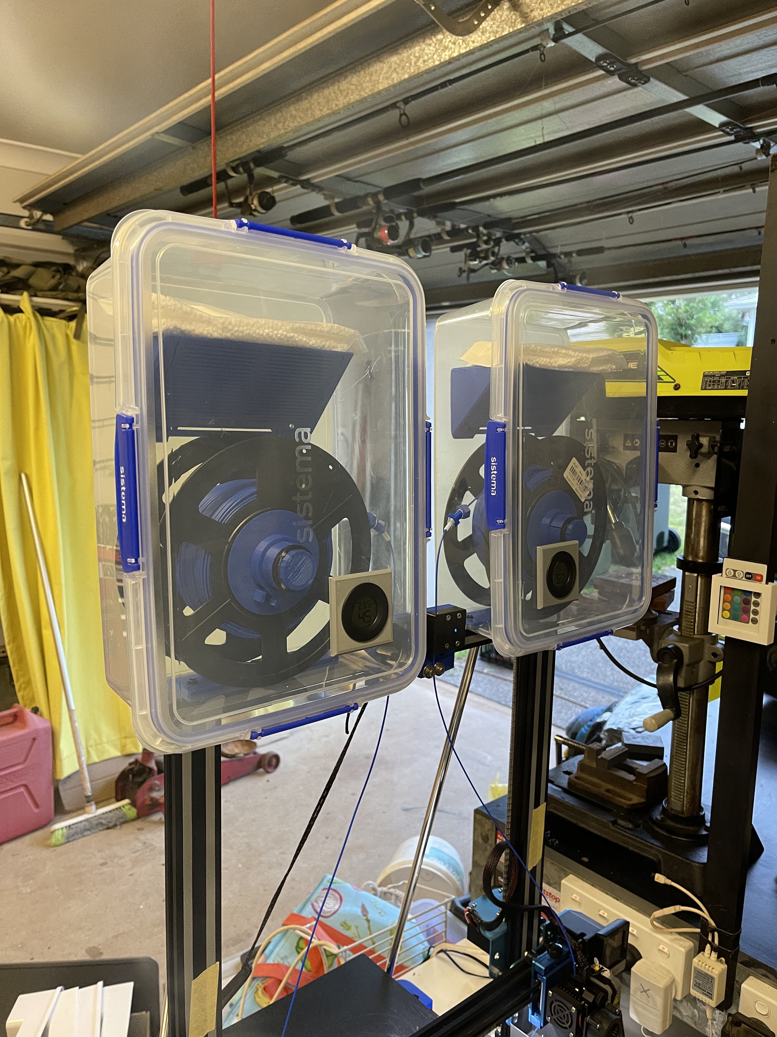

Also to your Tupperware boxes. Do they work well? I assume the shelf in there is for desiccant.

Hi again because I use 1kg rolled the ctr binder didn’t work it caused it to sag so don’t worry about that I replaces it with the red roll holder with the bearings that way the spool sits on it the spool holder is bolted through the container and is bolted to the gantry with a printed L bracket for extra support you will find the humidity difference in my case was significant like in the box was 12% and out side was like 65% humidity in cold places you could also put a reptile pad to heat up the inside of the box I am on the road so it’s a bit hard to get you more info but I will get it to ya in a day when I return
This is the container I used
