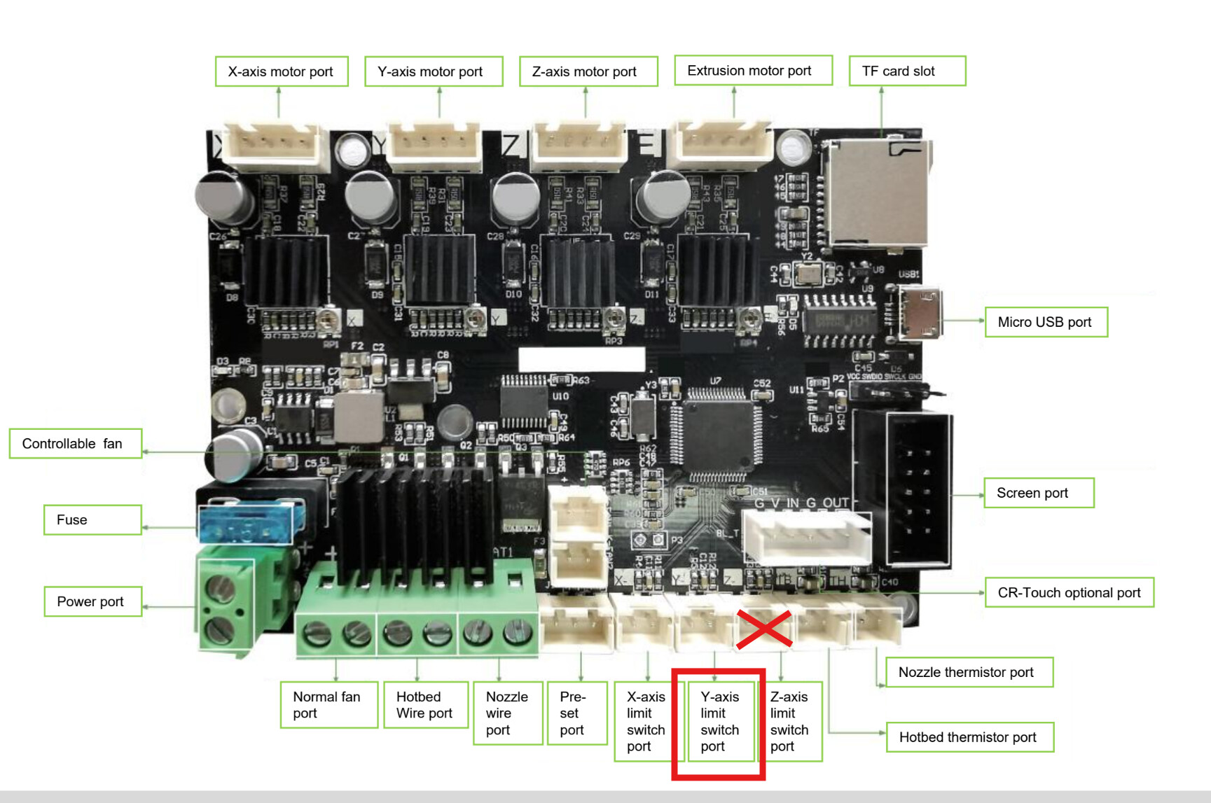

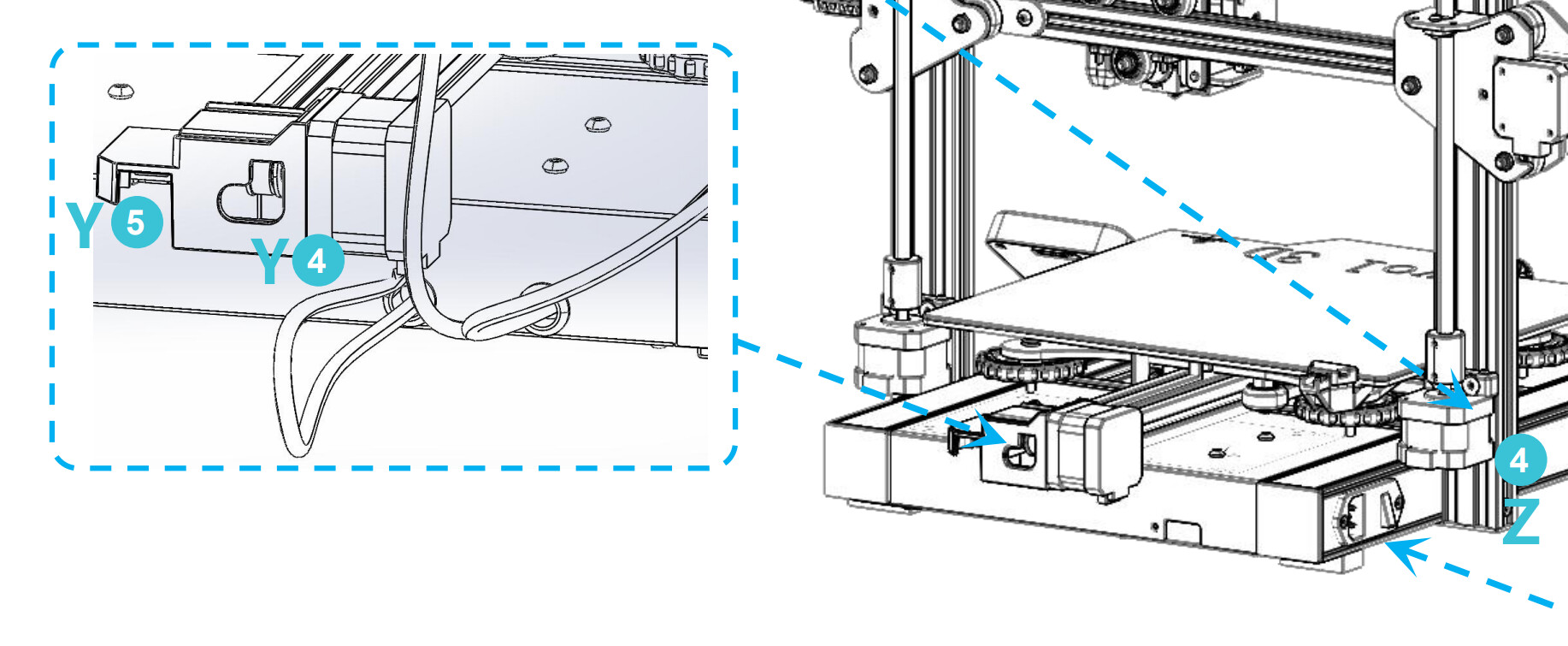

#5 is the Y axis limit switch
The BL Touch is used for the Z axis so nothing should be in that socket.

That limit switch is in a hard to get to spot and difficult to confirm visually that it is seated right, once I got it plugged in right everything was smooth sailing.
