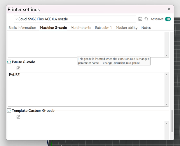

Orca Slicer, however, didn’t know how to call the macro. You can fix that by opening the printer configuration, select the “Machine G-code” tab, scroll down to Pause and edit it to read PAUSE (all caps). My version of Orca (2.3.0) already had it fixed.
Note: Orca still inserts the comment line THEN sends the PAUSE

Cardoc was faster. The old printer profiles lack the machine G-code entries for pausing and changing filament. This should have been fixed by now. Orca provides a better profile with version 2.3.0.

To be clear, if I use the suggestion from @cardoc above to add the PAUSE message in the machine g-code settings do I need to do anything else with the macro, or does that invoke the macro and I can just run like that?
If you are running an unmodified Sovol configuration The printer should respond to any gcode file that has a PAUSE line as expected.
I’d forgot about the filament change also being broken for the Ace twins in early versions of Orca.
I edited this from the original machine .jason file so that every time I loaded it would be there. Then I went to change it for the .2, .6, and .8mm versions and weirdly it was already there on those. So to be sure this invokes the existing macro and once I add it I don’t need to actually click the macro or anything for it to work? Or are there additional steps once I’ve added this to the machine gcode information?

SV06 ACE or SV06 Plus ACE, I showed it there. Sovol forgot the entries for pause and filament change in the machine code. Orca 2.3.0 added them, and Sovol then expanded the profiles for the ACE. You probably installed the old Sovol profile from the memory.
For what it’s worth the profiles you linked all have the pause code in them except the .4mm nozzle for some reason. It looks like Sovol forgot to update that profile or there was a regression. I believe this is the current page for their latest profile and a quick ctrl+f does not find any instance of the word pause.
