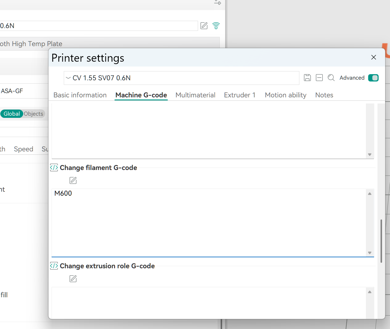

I’m having the same issue. Natively the profile does not respond to a colour change in Orca, so I added the M600 code to the Change Filament section. Klipper shuts down.

I have a kludgy work-around. In Orca Machine G-code setting, type PAUSE (in caps) for the filament change g-code.
The machine will pause immediately after printing the purge line and before starting the print (which may be a clue to the recursive error in my log). Hit the “Play” button and it will begin the print.
It will pause at the filament change layer. Manually do a long material retract, load the new colour, extend the filament (twice, to purge the nozzle) and then hit play again to finish the print.
PITA, but it works.
