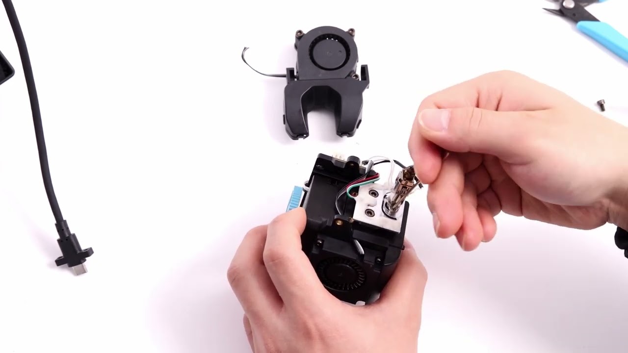

The printer comes with a wrench for changing the nozzles. The lever arm and strength of your hand should be sufficient. It is important to hold the hotend with an open-end wrench, as the hotend is not secured against twisting.
And it’s necessary to warm at 200° the hotend before trying to unmount it.
Thanks for the tips! Indeed, will hot loosen/tighten and follow Sovol’s video guide (which is pretty good overall!).
