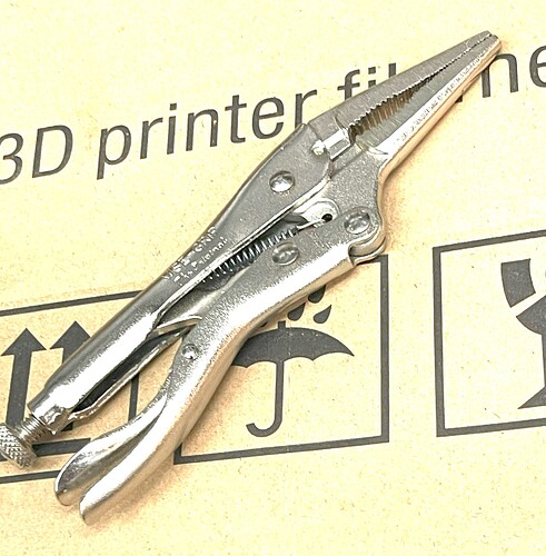

You need a universal heat block wrench.
The 4 inch are hard to find but worth the effort. Buy the name brand, the copies never lock properly. Yes it’ll leave a mark but being able to lock it on and leave it hang while you get the wrench situated on the nozzle is priceless.
I didn’t know there was a 4-inch length. Mine is 9 inches.
How can you use such a short wrench?
Mine are 6" total…and get your head out of the gutter :grin:
