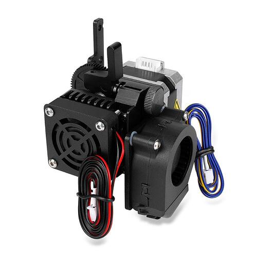

Dears, is someone using socks on the right nozzle ? in my case, the creality sock cannot be positionned properly around the extruder due the lack of the space along the extruder.
Do I have an assembly problem for this extruder ? Do you have tricks to solve the problem ?
Have a good day
Hi pierre06,
I can confirm that there are several assembly problems:
  • the black structure right from the heat-block is not supposed to be a that place.
  • the screw protruding from the heat block should not be present - it could bridge the heat.
  • The SV04 stock heat-block is rotated 90° clockwise - the heating wires usually point in the direction of the steppermotor
    This video should help to get an idea what went wrong.
Good luck!
Björn

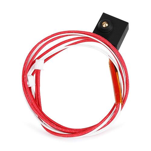

Also do you know if the heat block of the sv04 is the same as the one on sv05 ? as we will re-assemble the extruder, I want to get a fresh heat block and the sv04 one is not listed anymore in the sovol shops.
Maybe this:
Thanks @mich0111 your indication has allowed me to find the sv04 heat block !
