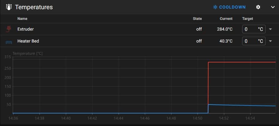

Hy All, i have a big problem. I just replace the hotend because filament stuck in. Restart and the heat sensor stuck at 283°, but the hot end cold az an ice block. Any have an idea what the problem? Thanks :slight_smile:
Most likely your hotend thermistor is shorted. Fix the wire routing or get a new thermistor.
I replace with a new one but there are the same :\
