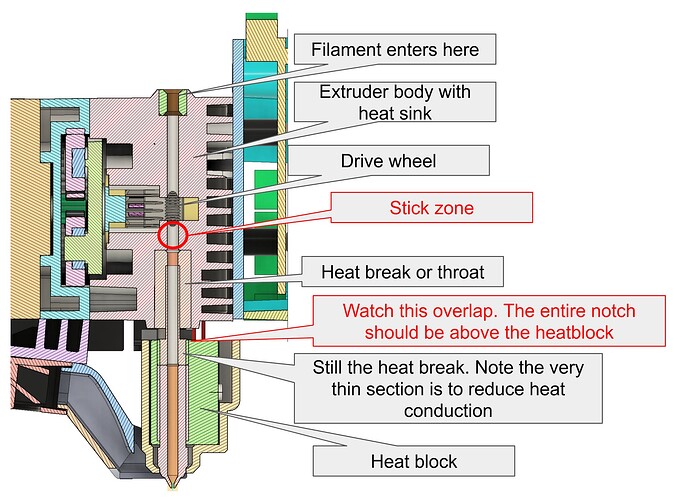

Ah, I wonder if there’s filament on top of the hotend that has a gap big enough for the acupuncture needle to get through but too small for filament, kind of like the video shows at 2:00. I’ll check for that too when I get off work. Thanks for linking the helpful video!
My guess is you are victim of “Heat Creep” where the filament gets hot enough to stick above the heat break.
Royal pain. Usually removing the hot end (heat block an heat break as an assembly) and a little hammering on an Allen wrench will pop it loose.
I’m printing again!!! It turns out it was a piece of filament that had broken off after the extruder gears and at the top of the hotend tube so it couldn’t melt but it was preventing the filament from entering the tube. Got that cleaned out and I’m back in business!
