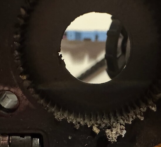

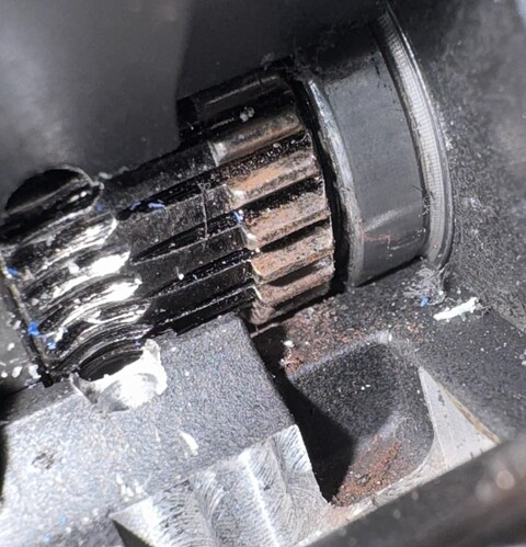

On my SV08 Max I was getting extruder problems that seemed to be getting worse. I disassembled it and there was rust on the main gear that the motor engages with, and when I opened the planetary gear section it had no lubrication at all and was chewing up the plastic outside toothed area that the planetary gears engage with. Has anyone else had a similar issue? What sort of grease should be in the planetary box?

Photos attached. Does anyone know what lube should be used? On my standard SV08 it’s full of a white grease.
The rusty gear in your picture is the one that drives the second roller in the movable lever. No lube should be used at that location as it will migrate and get on your filament.
@sovol3d Those gears SHOULD be plated with a rust resistant material.
Send those Photos to Sovol and demand a new toolhead. My guess is that Sovol’s supplier shipped parts that were not correctly finished. Sovol didn’t notice or used them to meet production schedules with the hope they would work.

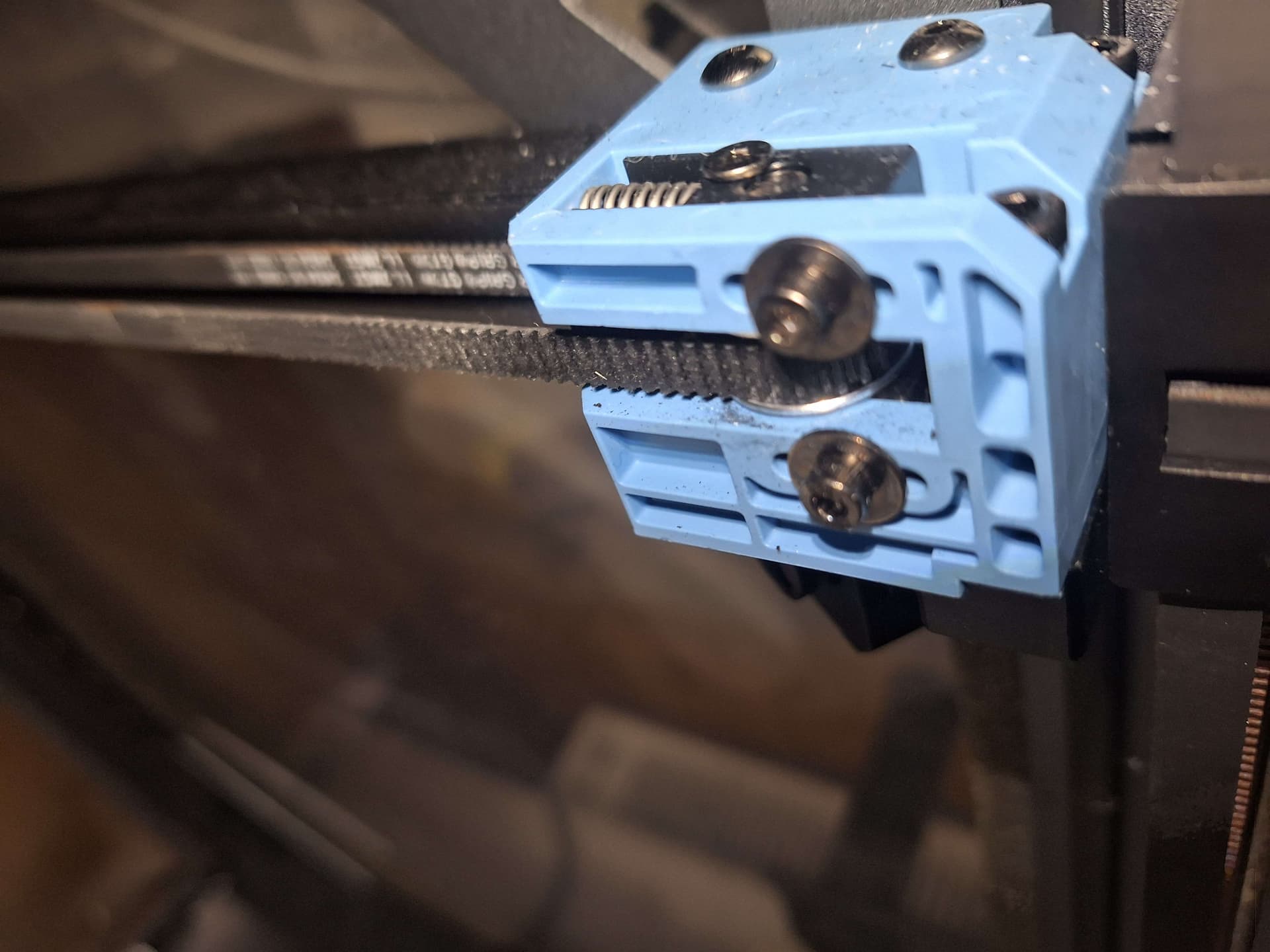

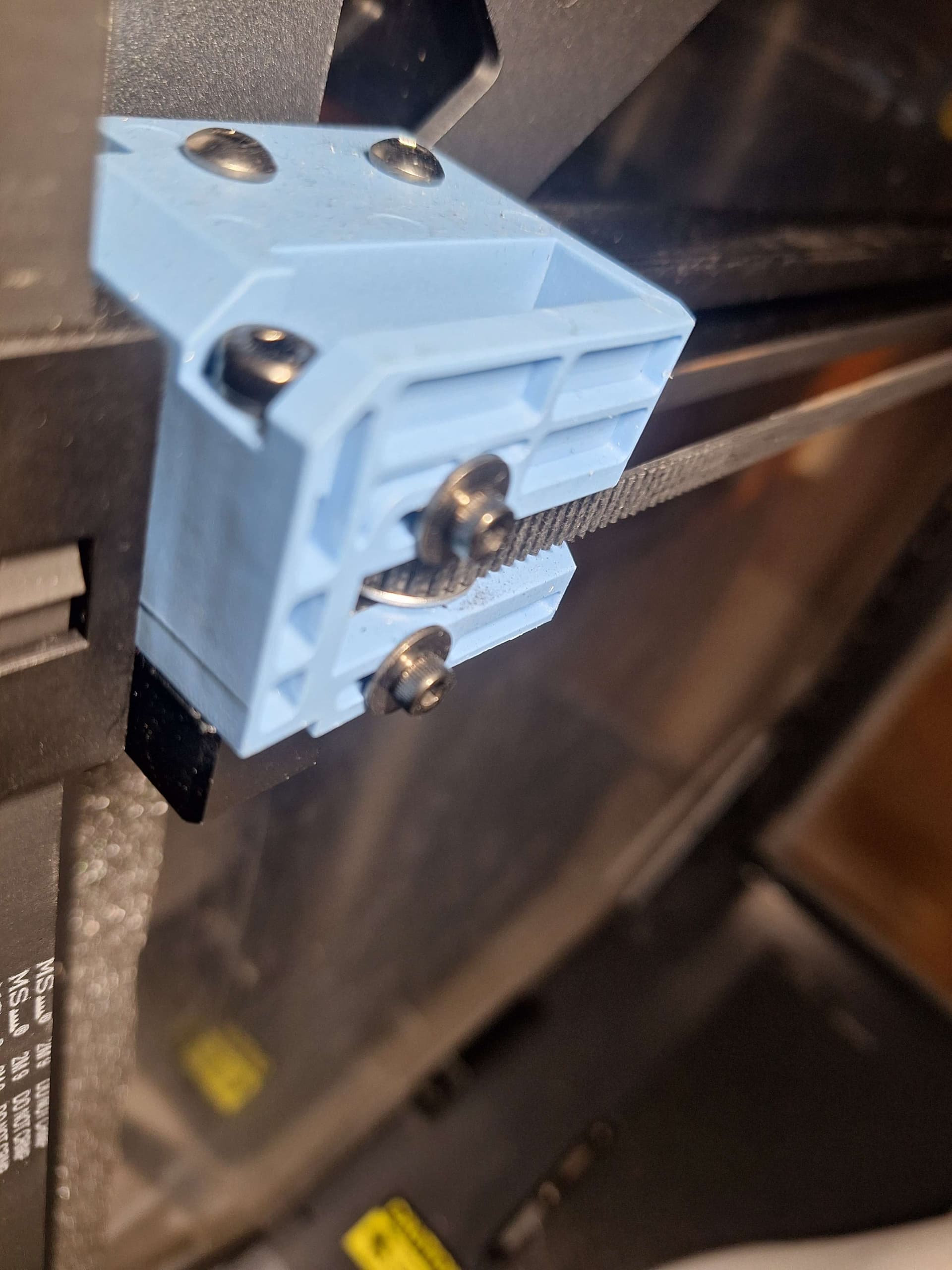

Not strictly related to topic but I realize that belts tearing down pretty badly
