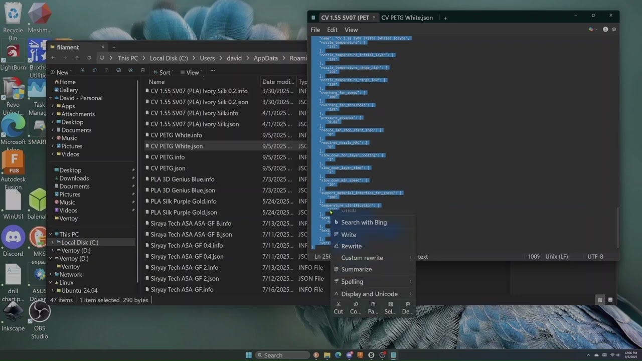

I have no idea if this is true but I tried exporting my versions of CV’s filament profiles and it wouldn’t let me. This leads me to believe that Orca has hamstrung the import/export function (perhaps to placate Bambu).
Load the .jason files in notepad and recreate the profiles. There are only 5.
Alternately get an older version of Orca, import then upgrade.

I guess it means “read the content of the json file and use the values in there to create a new profile from scratch”.
Open the .jason file in notepad or similar. They are easy to decode.
Open Orca and select a generic filament profile of a similar type. Edit the values to match the .jason file then save with the new name.
