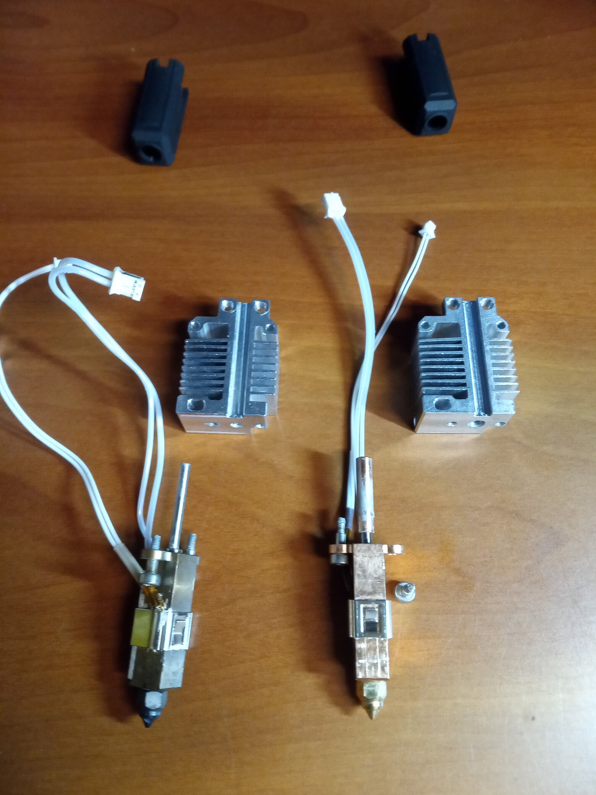

not all hot ends shipped are the same. the one on the left with the black hardened nozzle was the version shipped in my Zero and the right is the i bought to replace it. i have had allot of clogs with both PETG and ASA but none with PLA.
Utilisez-vous la bonne température pour ces filaments ?
ASA must be at least 245°

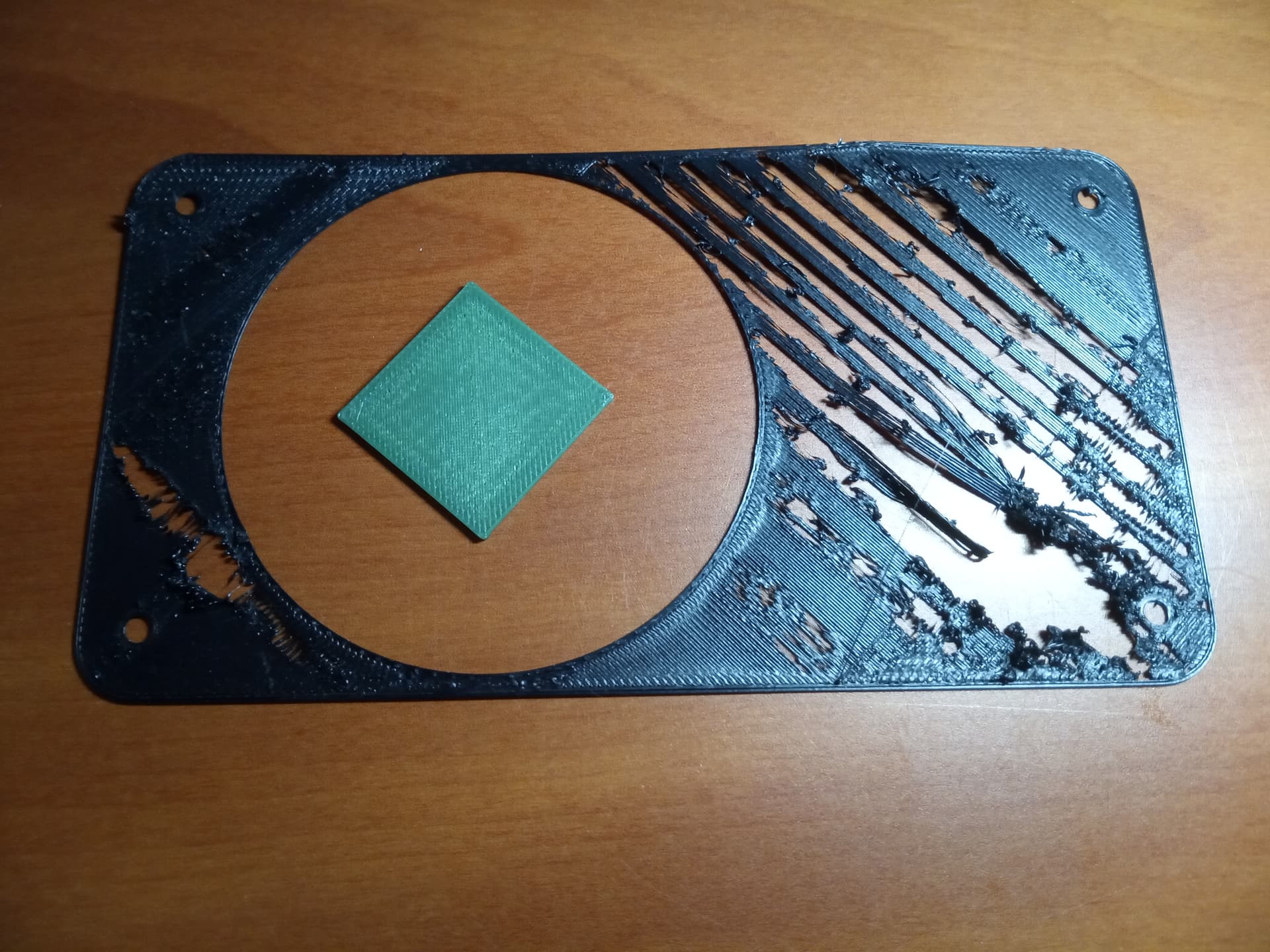

the black is Esun ASA set to print at 260 C. the max suggested is 270C and the green is PLA so its not a tension issue for the stop and start of printing and it not simple a bed adhesion issue the top left corner is the start of the next layer and you see the same as the first layer.
Were those two parts printed consecutively? Without adjusting the filament tension? If so, do you have calipers so you can measure the diameter of the filament? The black Esun ASA filament might be undersized, resulting in under extrusion. If that’s not it, do you have a different ASA to test to see if it might be some other problem with the filament?
If the green part was printed before the black ASA, maybe the ASA induced a clog?
Maybe try putting masking tape on the filament 100 mm above the top of the extruder, extruding 70 mm in Mainsail, and then see if you have close to 30 mm of filament remaining. Significantly more than 30 mm would confirm under extruding and the extent of the under extruding. Look at the filament as it’s extruding. Does it emerge vertically from the nozzle in a regular stream, or is it coming out a bit at a time with pauses in between (extruder gears slipping, chewing the filament, set screw loose on the extruder drive gear, etc.) or does the filament squirt out a bit sideways (nozzle clog)?
With the nozzle at printing temperature and the stepper motors engaged, it should take a significant force to pull the filament back up out of the extruder. If the filament pulls out with only a little force, there is some problem with the extruder gears grabbing the filament. Ensure the tension mechanism is working properly. I’ve had to unscrew the thumb screw, disassemble the screw, washer and spring, and reassemble them so the spring and washer aren’t binding so they properly tension the idler gear.
I did a Google search & found 3-4 posts that said printing out of bounds at 275* worked for them. It has been reported to eSun.
Do a flow rate calibration in Orca.
Different filaments interact with the feed rollers (gears) in the extruder differently. Some people calibrate their extruder rotation_distance on every filament. That doesn’t, however, account for variation in filament diameter so you still need to run a flow rate calibration.
I leave my rotation distance at “stock” and do a flow rate calibration for each filament. Once the flow rate is set in the filament profile you no longer have to think about rotation_distance or filament diameter.
