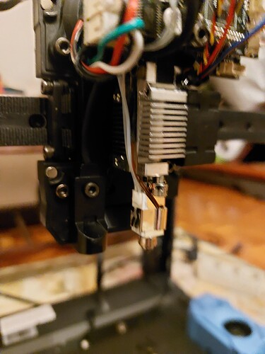

Are you using the old style nozzle or the new style with the hole in the side…??
I’m not sure i’m new with sovol (i had a prusa 10 years ago) i’m sending some pictures from the nozzle

Ok it looks similar i need to take my nozzle out and then compare it, i’ll do it next wednesday…thanks

It’s the new nozzle, not sure why you keep getting clogs.
