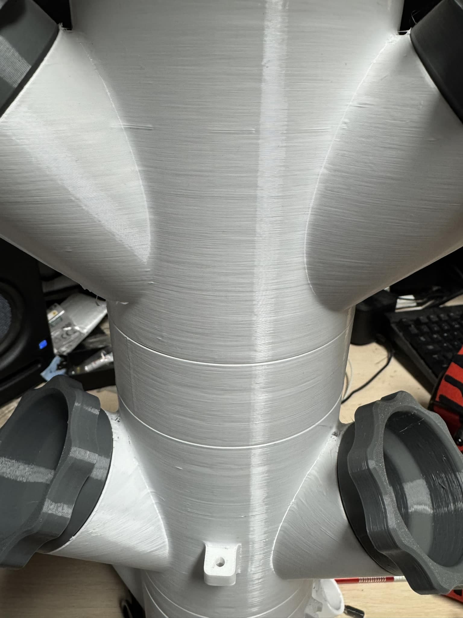

Hi there…
Almost from begining I’m stragling with this ugly layers on my prints… Now I have sovol 0.6 nozzle… PETG fillament. Same fillament, on the other printers - everything is perfect. I was trying differend speed, presure calibration, flow calibration… nothing helped…

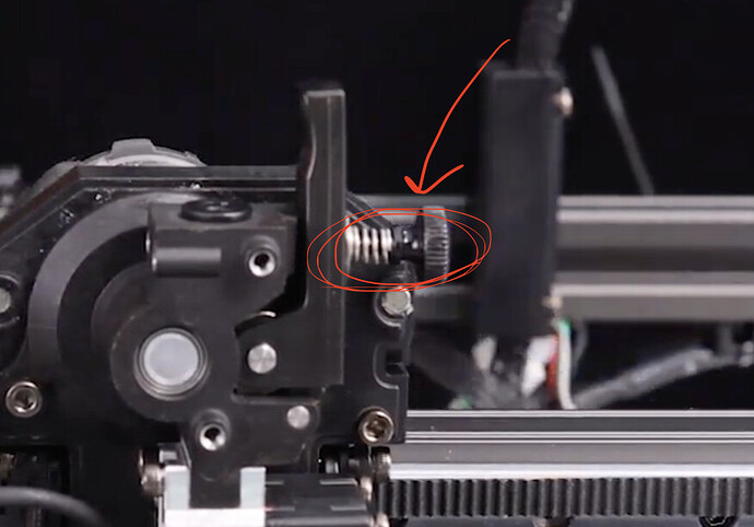

I noticed that this screw wasn’t tight at all (screenshot), so I tight it a little bit, and the behaviour totaly changed. Can it be the issue? If yes, is it any tutorial how tight I need to set it? Thanks in advance
Yes that is the tension screw. It adjust how tight the filament is grabbed the the gears.
This is a basic video with a bowden setup, but the principle is the same.
Sovol’s are pretty much always on the tight side, so I would screw it in all the way…not tight…than back it off 1/2 or 3/4 a turn…and adjust from there…JMO
