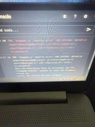

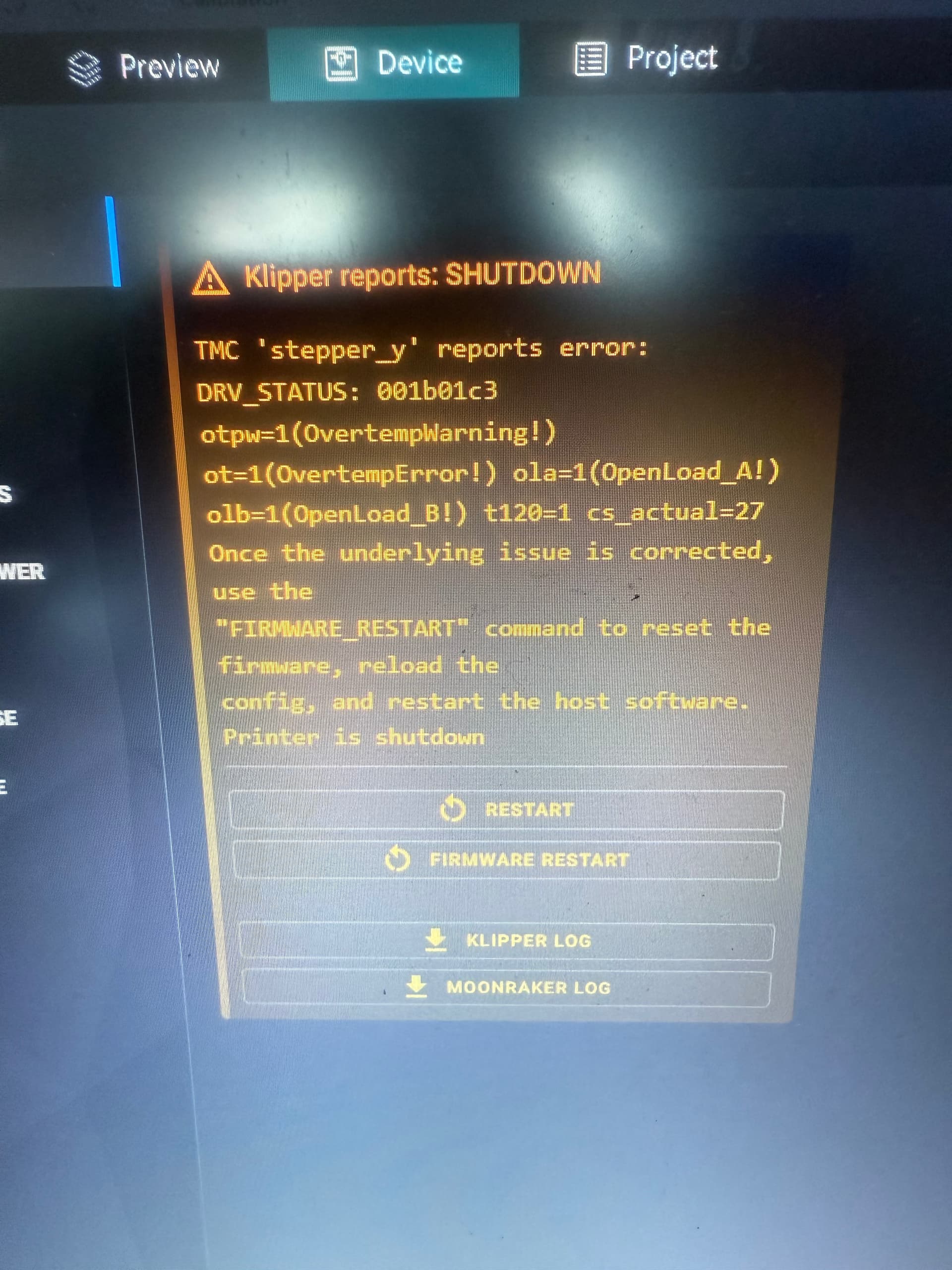

Thanks for the suggestion leon, I did send them an email but I don’t know how efficient is the customer service. That’s why I came to the forum looking for help in case someone have experience this kind of issue before. I have some pictures of the actual error just in case I didn’t explain myself correctly before. I will really appreciate if anyone can help me out in this situation. Btw i did notice today after trying to get the printer to work I checked the stepper motor based on a youtube video for shorter and it seems to be fine also checked the wires from the mcu to the motor and also fine but sometimes weird I noticed is the motor was getting hot even without being used just by the printer being on an everything cold to touch after around 10 minutes i got the warning and the motor was really hot. Im starting thinking that maybe a shorter in the board at this point. Thanks for the help to anyone that can help me out.

Thanks for answering angurisneo i was emailing back and forth with the customer service at sovol. And after performing some tests they suggested me they diagnose that could be a few factors. Starting for the motherboard fan that it wasn’t performing correctly that could elevate the case to fryer the Y stepper motor or fryer the motherboard driver. Anyway they already told me they will send me a new Y motor, a new motherboard fan and a new motherboard just in case. I will try each one of them starting for the motherboard fan and i will let the community know what the issue was. I just have to wait for the part to arrive to start replacing them.
