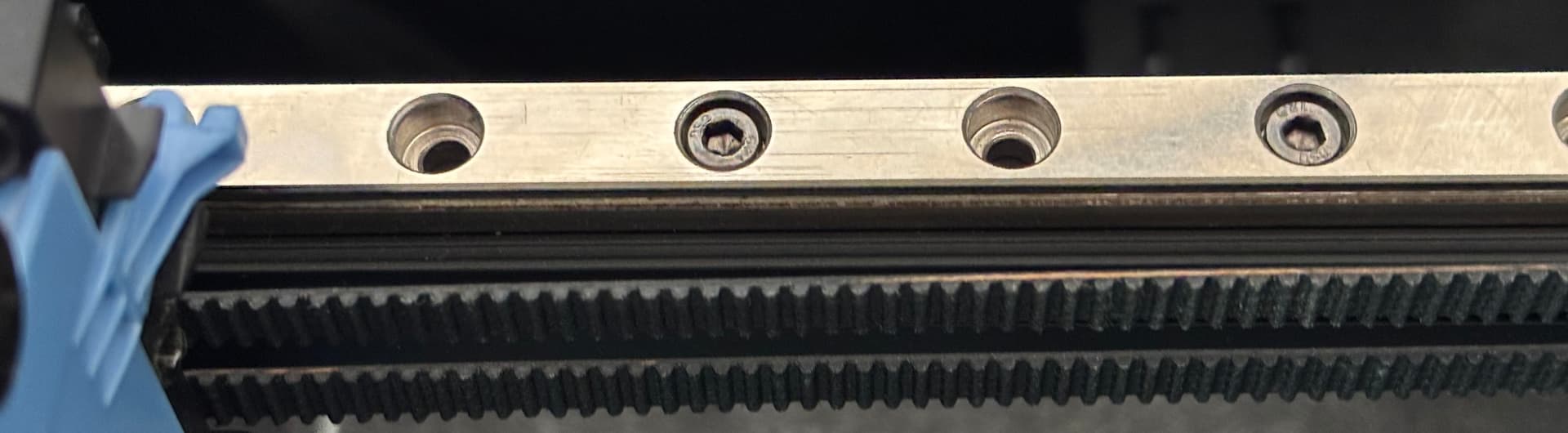

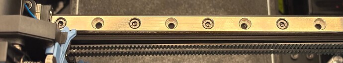

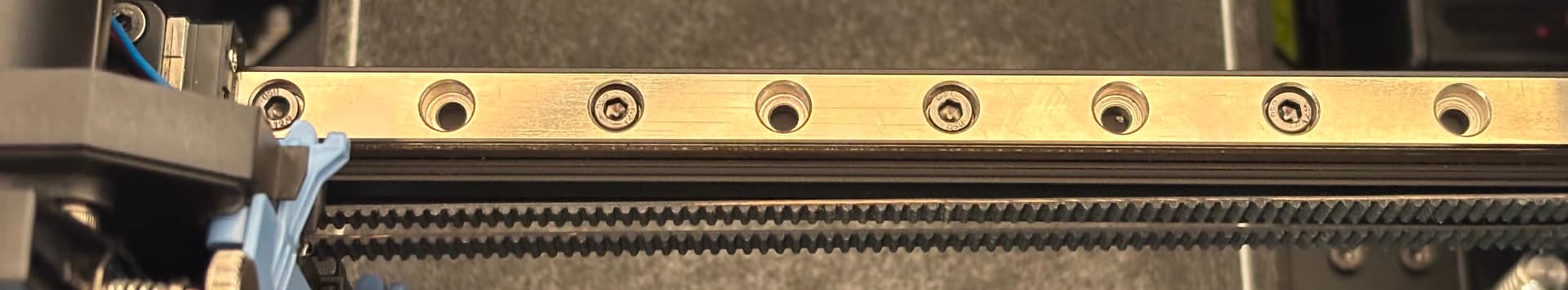

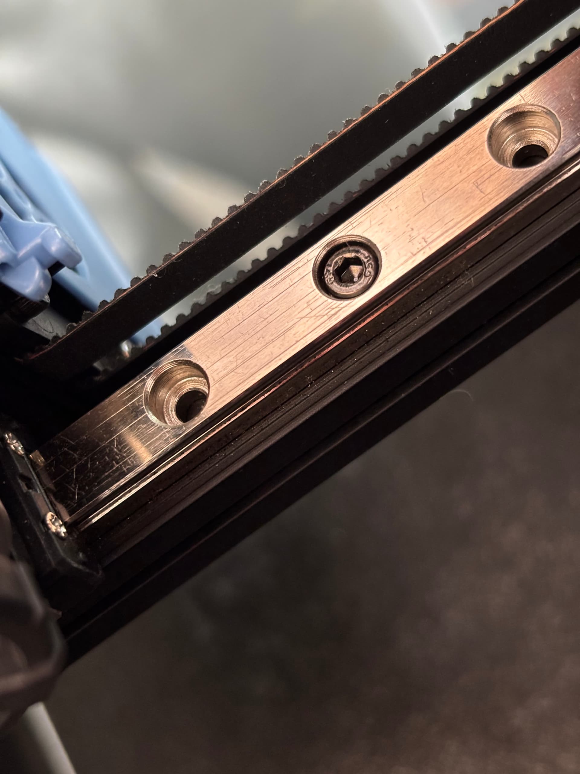

Haven’t had time to take the printer apart to inspect the rail carriage but I did just notice these scratches. Hopefully the pictures are clear enough

Looks like the cause for x has lost all lubricant.

I’d request a new rail from Sovol. No possible way it isn’t damage. And if properly lubed when it was originally assembled it should NOT have gotten that bad in 6 months.
