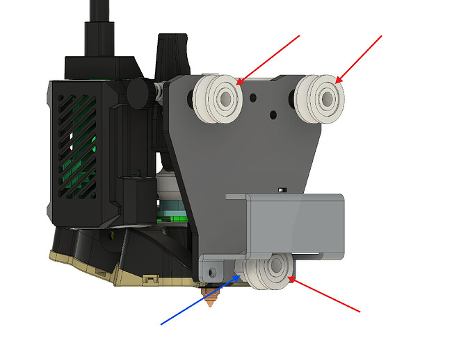

The toolhead on the Ace is on rollers (Red arrows).
NOTE: my model (sourced from Sovol’s github) is missing all the screws.
Each roller has a ball bearing inside.
Blue arrow is an excentric nut that moves the lower roller in a small circle and controls how tightly the rollers clamp the rail. My guess is you have a bad roller.
@sovol3d - I don’t see the rollers being available to buy.
I don’t know how to tell you how to adjust for the correct amount of clamp.
Rollers could be repacked with grease as a temporary measure to get use out of your printer while you source new rollers but it is a messy undertaking.
