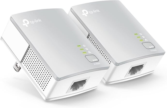

Another option is “powerline ethernet”.
I used similar for house <> workshop connection a few years back. Worked better than okay but not perfect.
I tried Powerline years ago…worked like shit for me.
Tried for 2 days then sent it back.
Your plugs were probably on opposite legs of the Mains power. They make phase couplers to put in your breaker box to get the high frequency signal from one leg to the other.
