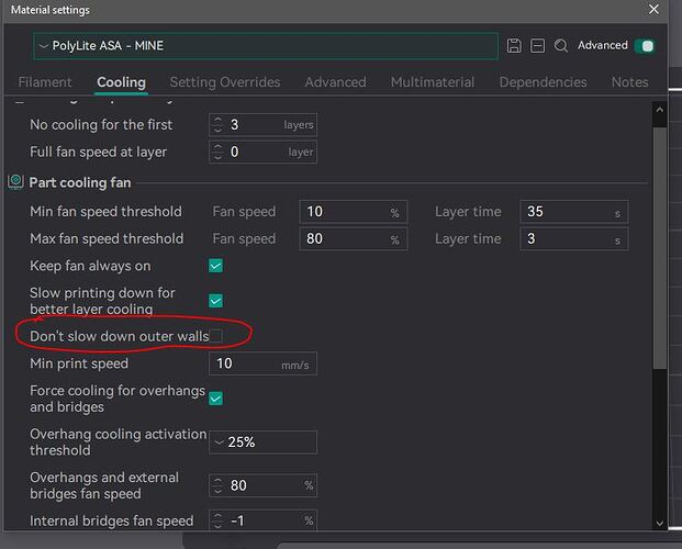

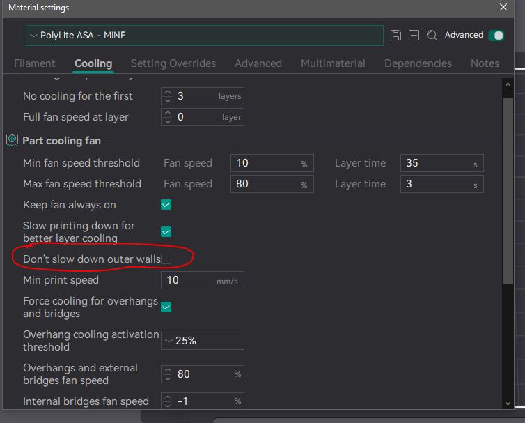

Try turning this off if it is checked.
I will check that, but I am reasonable sure it is not checked. I have slowed the outer walls down considerably and it’s a snore fest watching the outer wall print.
I reset the machine, checked to make sure the do not slow down for outer walls was not checked. I also calibrated the steps to value 6.62 turns for 100mm filament. Checked belt tension. Looks to like it is under extruding compared to my K2 plus.
