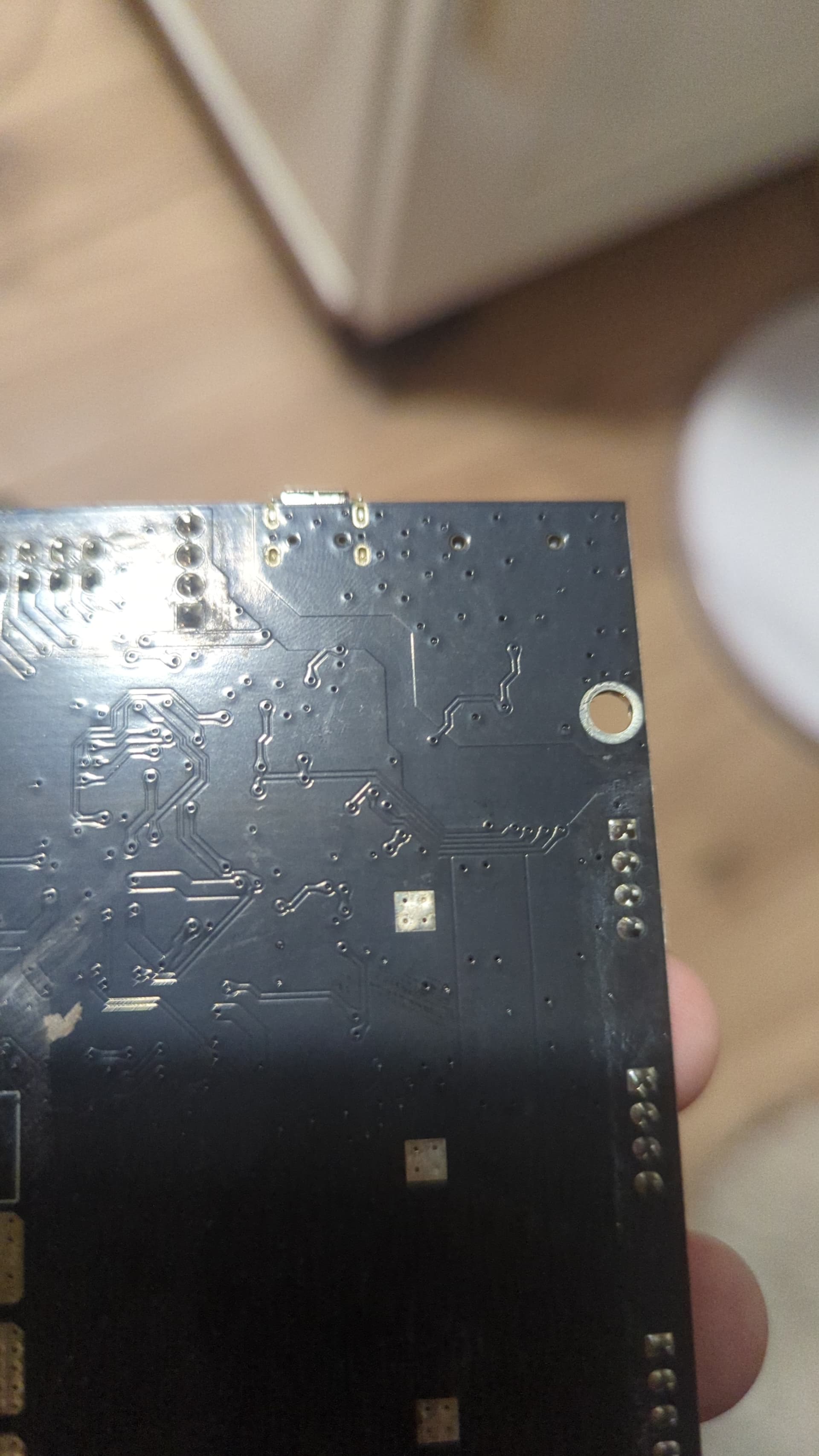

And I don’t think the card reader is on the motherboard. I think it’s probably connected to the motherboard through a USB port.
Where do you see a connection ?
I can’t see card reader.
On the first foto on the right lower corner. It’s a card reader to the left fro him it’s a micro usb connector. On the second foto you can see that the usb connector goes to the other part of the board.
Btw you can’t connect adapter to micro usb and use it like a sd card reader. Micro usb on this board used for “smart” connection. Like a pc or octoprint connection.
Micro usb connector goes to the “smart” part of the board.
I don’t have my printer in front of me too, so I trust you.
