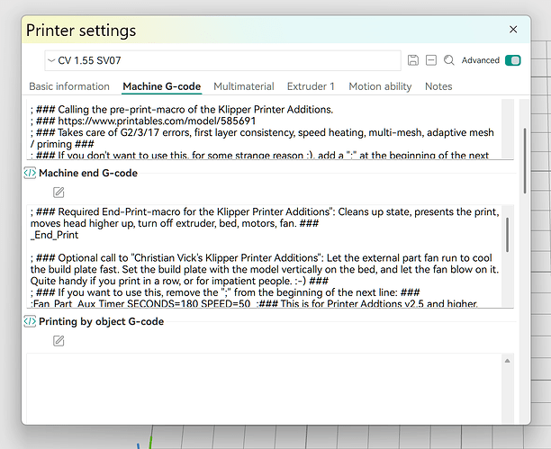

Check your “Machine end g-code” in Orca for both printers. I bet there is none for the SV06+
Note: don’t try to copy mine. Copy/paste from your SV06 profile.
