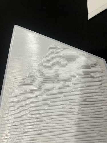

Second layer help please!
this random shit just started happening … nozzle is mot clogged feed is not jammed its a separation of the layers for some bazar reason .. any ideas? also it doesn’t matter the filament I’m using either I’ve switched rolls and no change
Please adjust Z-offset. You can refer to it: https://www.youtube.com/watch?v=EU1PPdsZBuE&t=84s
this is on the second layer not the first
If the Z-Offset is off, it will be more noticeable on the 2 & 3rd layers.
If the red circle is your 1st layer, then you are off…I’d like to see a pic of your 1st layer.
Are you using a brim or printing on a raft..??
