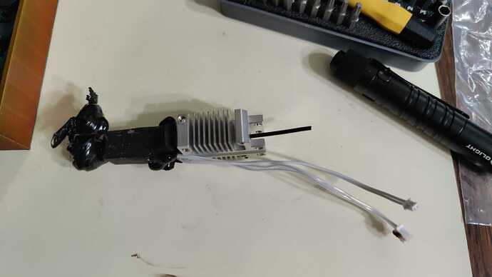

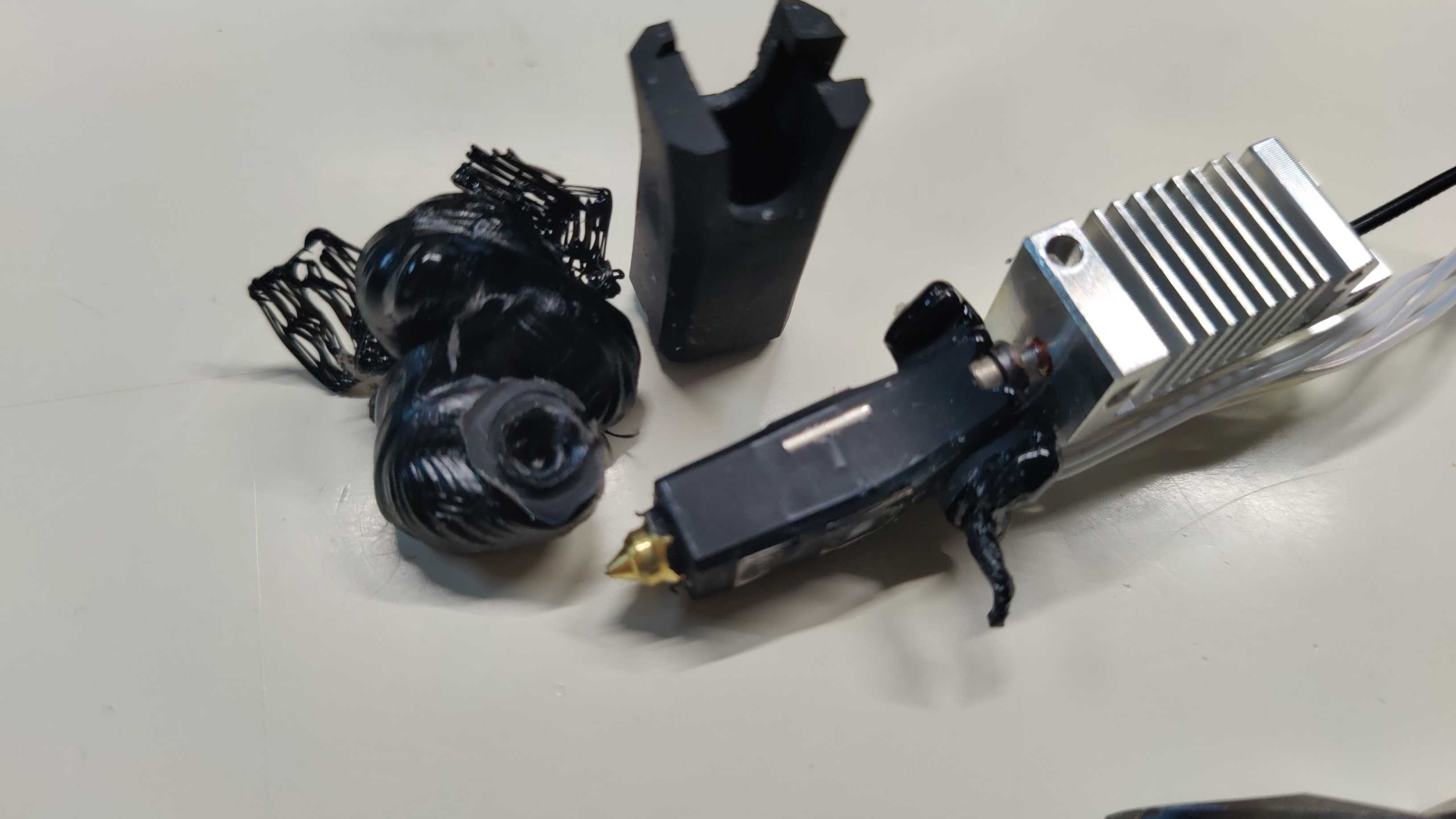

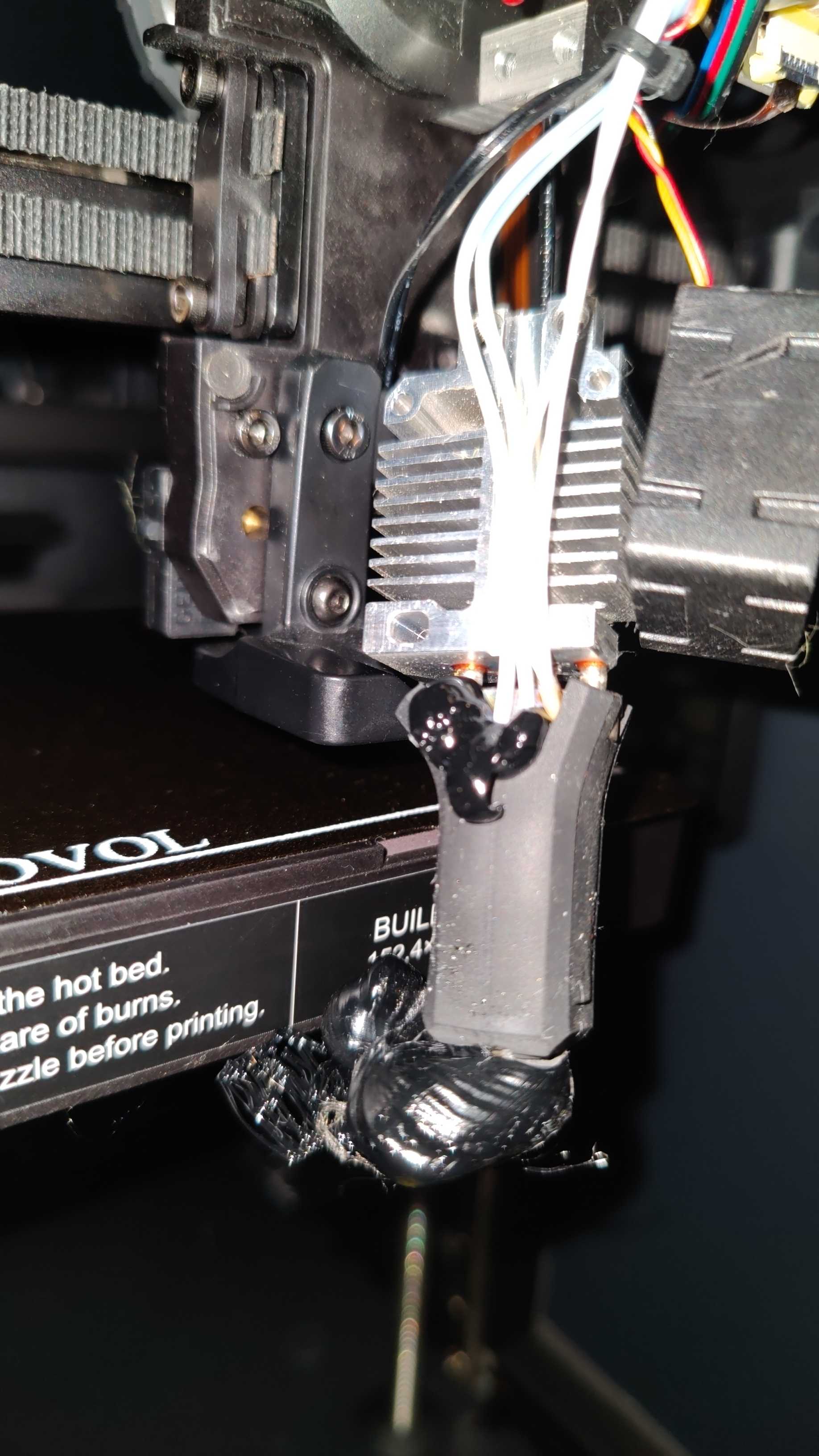

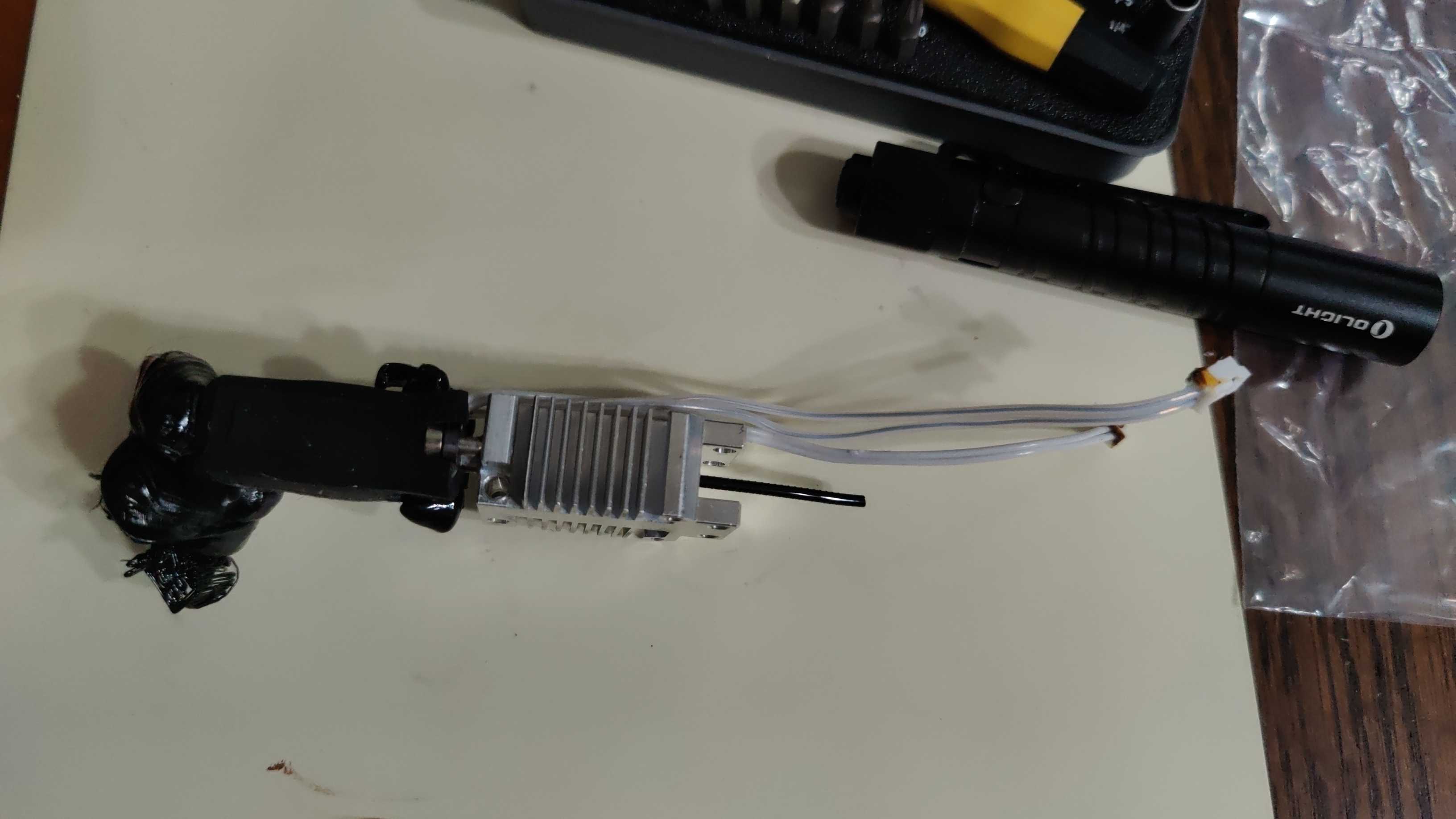

Does anyone know how this might have happened? I mean how does it flow back up into the silicon cover like that? LOL Thought I’d share a interesting evening of fun. :mechanic: :rofl:
Printing in Black PETG, around 40c in the chamber. Nothing fancy, 12mm3/s (HS PETG). The only thing I had done was swap out the worn out original brass nozzle for a replacement. I know I tightened it, even snugged it down after the original replacement to make sure heating and cooling had not loosened it. Printed 15-20 prints after replacing it, no signs of trouble.
Anyway, happened to have ordered a replacement head and swapped it in, off the the printing again..

Usually this can happen when the nozzle is loose. The filament leaks from the block back up into the sock.
Hello,
You can try cleaning it using a heat gun, but do so very carefully.
If you do this, be careful not to break the thermistor wire.
If the model gets stuck to the nozzle, it will cause the filament to back up into the sock also.
Thanks for the answers. It has to be either the nozzle coming loose after I replaced it, but I’m doubting that due to me just tightening it a few prints prior, I’m thinking the model coming loose, the print had just started. I’m still very new to the 3d printer world and had not seen videos or experiences a backup like that inside of the cover, found it interesting and shared.
