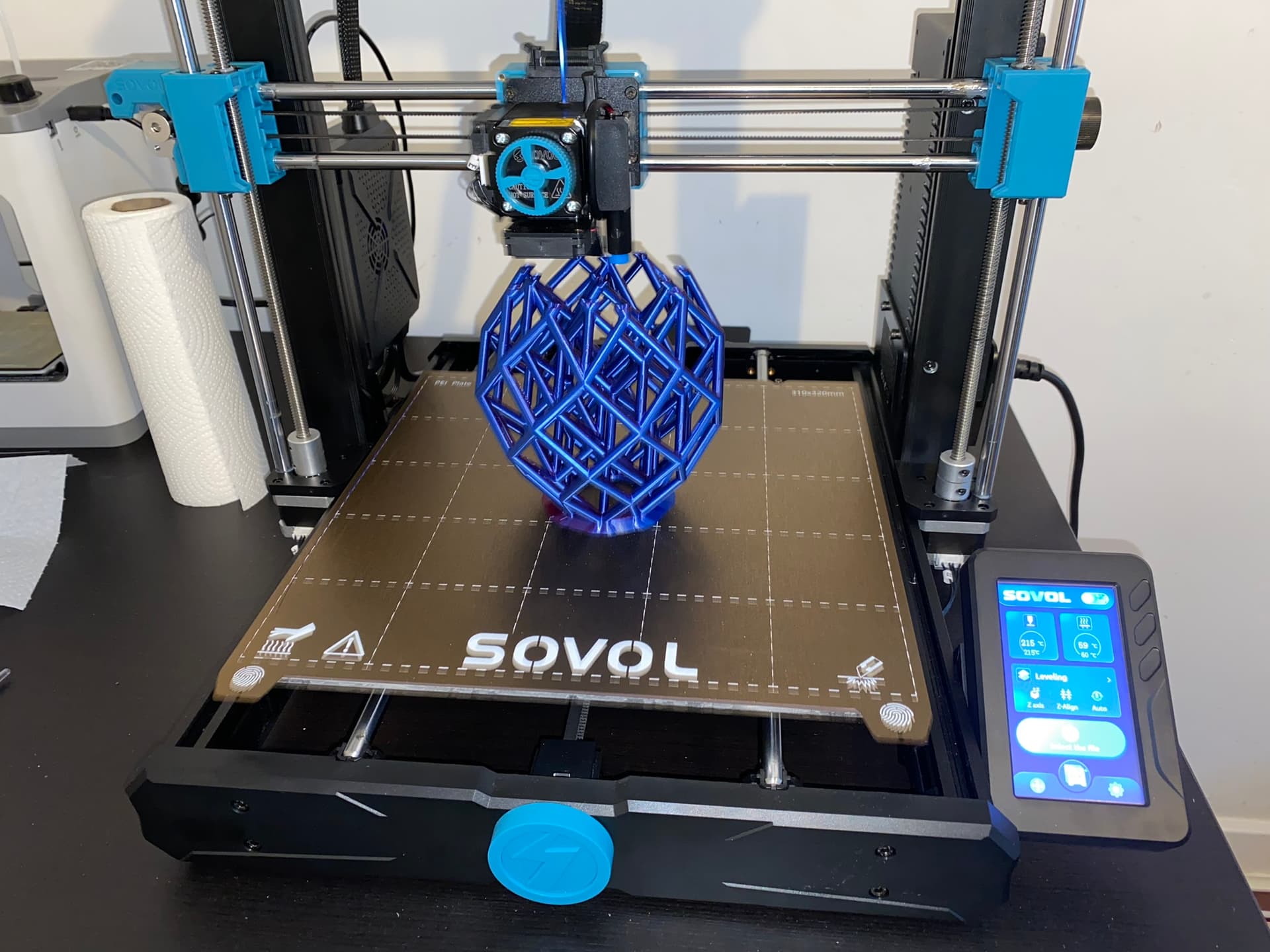

Hi community! Thanks a lot for all of your help and feedback.
I tried many things and i learned a lot during the last weeks!
I think my printer had several issues:
  1. The cable from the print bed was sometimes stuck in between the frame - this caused the crazy sound! There is a holder which bends the cable a little bit to the top - and this improves the situation a lot!
It seems like a few people have a problem with that as well - and there are some models on printable to fix this issue - like this one: https://www.printables.com/de/model/462159-sovol-sv06-plus-bed-cable-guide
  1. i also had a problem where the cable of the proximity sensor was loose - so the bed levelling always failed - so better check the cable connection (thanks to Sovol support who pointed that solution out)
  2. I still end up with really bad prints - and i think the min reason is still the wraped bed. As i mentioned the spacers under the bed have a different length - one of them is nearly 2 mm shorter than the others…
    If i print a test print over the whole bed - i end up with this result (i stopped the print after half of the print):
    I would stay that there is a clear problem with bed adheasion - and i found a video and a tool to visualize that:
    I Leveled My Printer's Warped Bed using a Mesh Visualizer | Sovol SV06 - YouTube
    I use Pronterface to create a mesh - and thats the initial result:
I will use some heat resistance tape to fix this wraping - thats the tape i ordered: https://www.amazon.de/gp/product/B07R8PJ23X?ref=ppx_pt2_dt_b_prod_image
Overall i must say that im regreting that i bought this printer. Instead of printing i end up trying to get my printer to work… I learn a lot - but i would not recommend to buy this printer or any printer from Sovol right now. The support from Sovol is very limited - and they only reply occasionaly and its not very helpful…
I will try a differnet slicer as well - thanks for the hint: Dennis !
If you have any better ideas - or have any thought about the wraped bed - let me know!
Thanks a lot agin to everyone trying to help!!
Peter

Hi Peter,
A warped bed caused by one mounting spacer being a different length to the others will completely ruin any chance of good print quality and bed adhesion.
Don’t waste time on half fixes or workarounds - get that distortion of the bed surface fixed! I’m surprised you haven’t done this already as you’re just wasting your time attacking this problem from other angles. Your printer is defective as it stands now.
Find a straight edge like a steel ruler or spirit level and check the surface of the bed every which way. (without the steel PEI sheet fitted)
The maximum deflection from flat should be less than 0.5mm or so otherwise the 16 point bed levelling will not be able to compensate, that is only there to compensate for very small errors.
Contact Sovol and ask them to send a you a set of new spacers and/or a new bed. If it’s badly warped out of shape due to incorrect spacers (the underlying bed material is aluminium so would warp easily) it’s unacceptable and should be sorted out under warranty.
Your bed shown by the mesh visualiser is about 0.8mm low in the corners, here is mine for comparison:
I’m getting perfect first layer adhesion time after time. Here is an example of the bottom side of my Octogon test pieces where you can see the fine but uniform texture from the bed surface showing good adhesion:
Yesterday I was printing the following model directly to the bed with only a small brim - notice the tiny area in contact with the bed relative to the size and height of the model - it did not come free of the bed at all and was still firmly attached to the bed after nearly 24 hours of printing when I had a power cut at 90% completion…(Ahhhhhhh!!)
That would never print without breaking away unless I had really good bed adhesion of the first layer.
It sounds like you have fixed or figured out most of the problems you’ve had like the cable jamming the Y-axis - now you need to get the bed warping fixed and Sovol should really be helping you here as there seems to be an assembly or tolerance problem with your printer from the factory which will never allow it to print properly.
These printers are capable of great results - don’t give up yet. In your position I would be asking for them to replace the bed due to unsatisfactory warping especially given all the effort you’ve already spent trying to resolve these issues.
