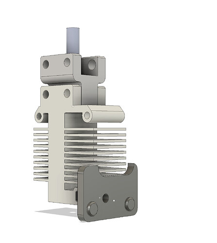

Mounting ANY SV08 hotend to the Zero wouldn’t be very hard.
The heat sinks are identical but to preserve the eddy position you’d need to lower it 9mm.
You’d need to layout a hole and put an insert in the extruder mount plate.
You’d also need a PT1000 that fits the target heater and relocate the MUC board (or extend the heater and PT1000 wires). Triangle labs sells a PT1000 for a stock SV08 but there isn’t a picture of it.
Cut a piece of PTFE tube 9mm longer than stock to provide a smooth filament path.
OOPS. I had the part fan turned off when I was considering moving the board… I don’t see a way to drop the MCU board without a whole new front cover.
is there any way that you could make this design downloadable? i bought the microswiss sv08 hotend and want to put it on my zero, but my rough designs make me nervous. this looks far more polished. especially that lower plate.
