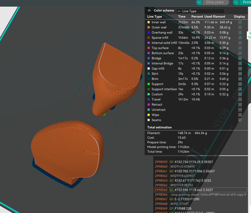

When you slice the model, the seem will be a white line.
the white line on the left side represents more or less until i printed (on this last print screen)
can i delete that seems? or what can i do to avoid it?
Hello,
In the settings of your slicer you can choose where you want the seam is for each model.
It’s to you to imagine the best place for it.
Btw, if you’re not confident with that, you can find a lot of videos on YT that explain how to set the seam.
