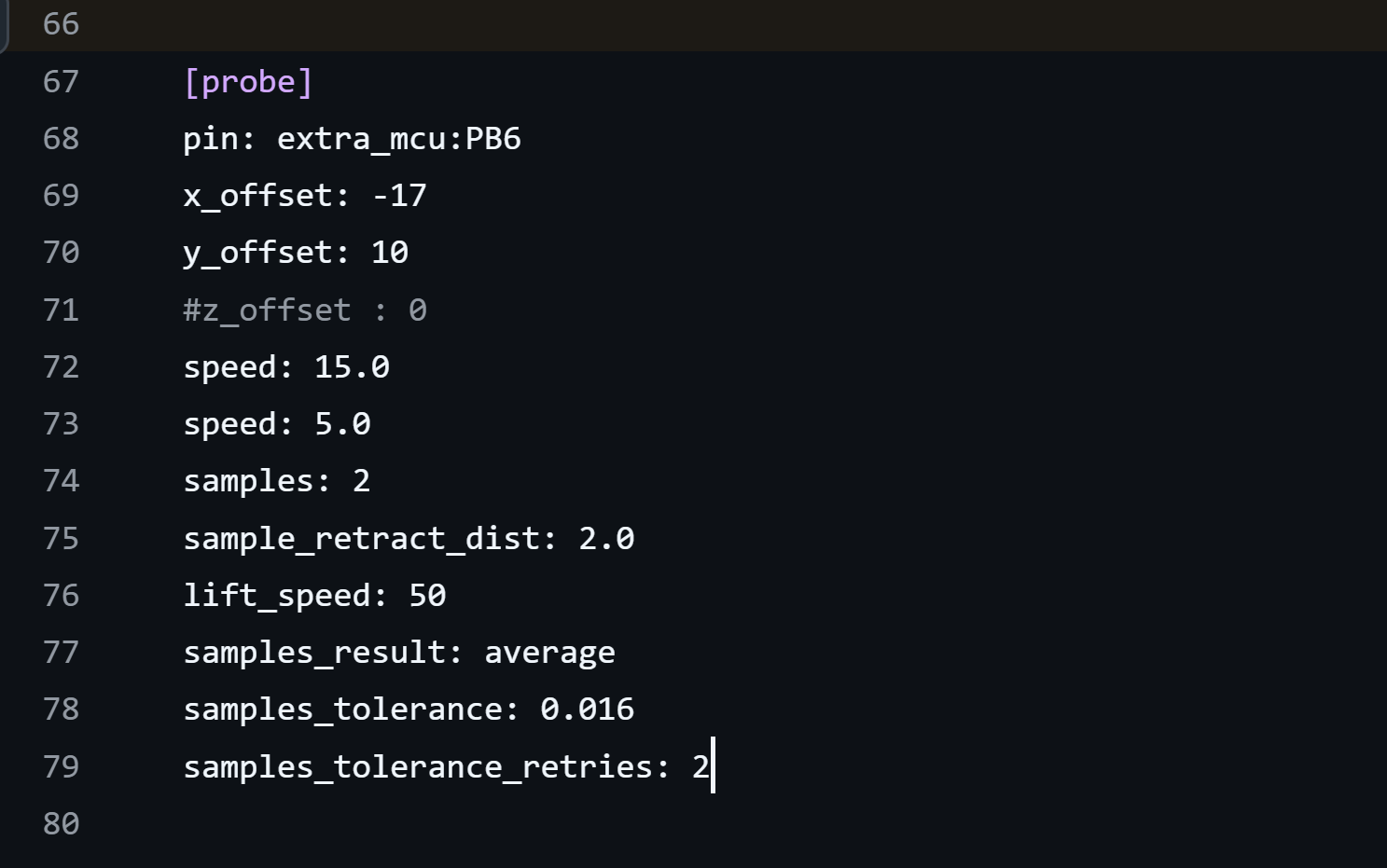

Never tried it but if you put a # in front of all these lines in printer.cfg:
Klipper can no longer access the probe
Which will error on any attempt to home the Z axis.
