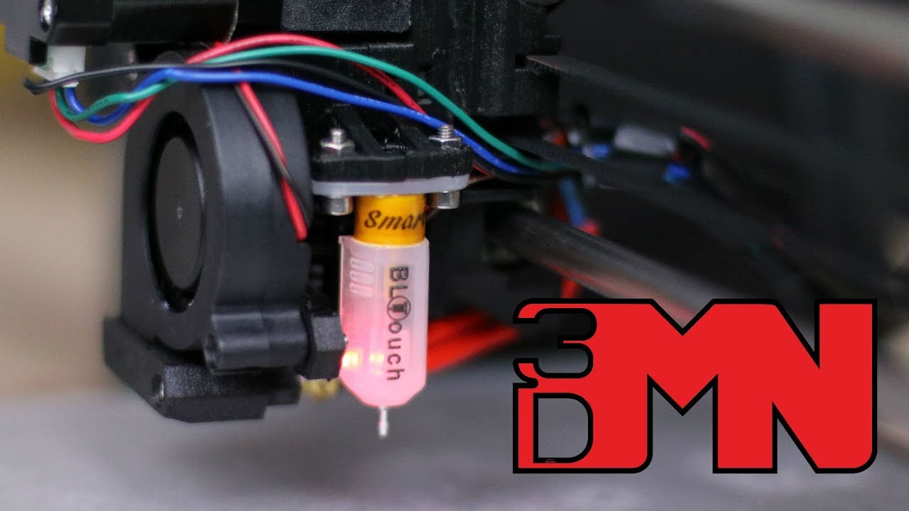

To explain the principal and more, I found this video on YouTube.
However, this video is showing a lot of details by going through the GCode. You don’t need that since you can do it from the screen on your printer.
So you can start the video at 3M25sec if you want and he will show what I was trying to explain.
Once you have your Z Offset figured out, make sure to store it in the printer.
