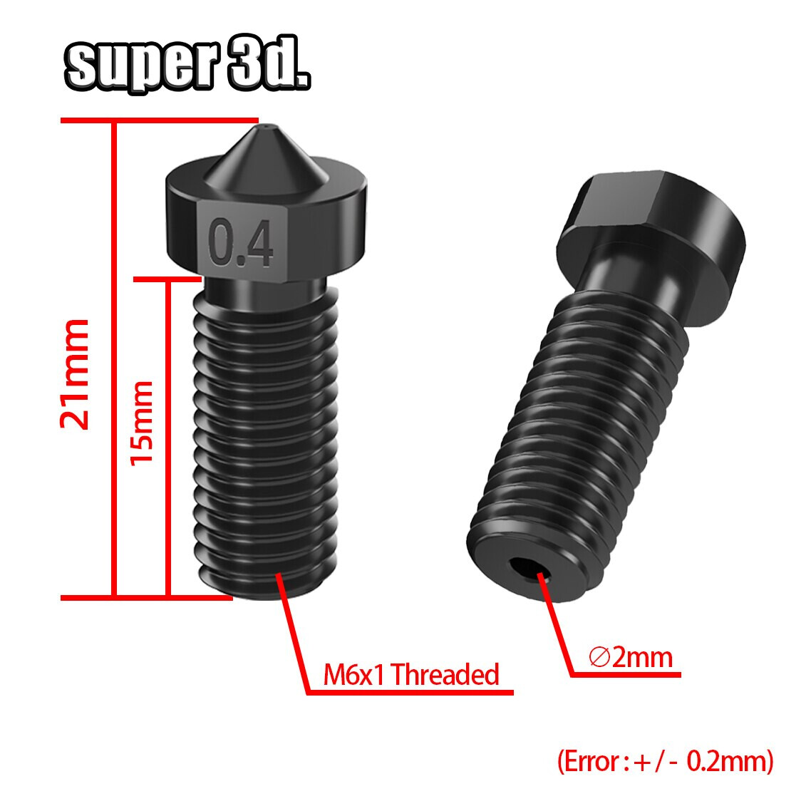

I need an extra 2mm to get glass down for this experiment. I’m thinking this is a winner.
That should leave enough room for a glass bed I think. better if I can find a 20mm length

That’s an interesting idea.
Just be sure your fan duct will point in the right direction. I saw where another person had to print a new fan shroud to use this type nozzle, as it directed the air toward the top of the nozzle, not the printing tip.
Right a new fan would be needed.
