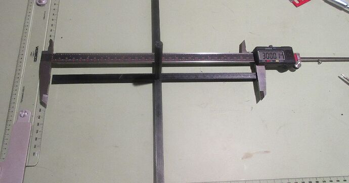

Note: most shrinkage test prints use small cubes. They are not sufficiently precise for the large MAX bed, but scaling them up increases print time and material use exponentially. I designed this quick and dirty (but highly accurate) model for use with the MAX (or any other large bed printer) :
do you calibrate dimensions by measuring both widths and lengths of your model’s beams and inserting values into the 2 equations(for length and width) system with 2 variables (xy shrinkage [%] and xy compensation [%])?
Wait for it to cool. Measure X. Measure Y. Hopefully they are identical, if not, average them. Divide by 3 (since they are 300mm long). Enter the value under the XY Shrinkage Compensation for the filament. Do the same with the Z axis (divide by 3 if you used the 300mm tall version, leave as is if you printed the 100mm tall version) entering it under the Z Shrinkage Compensation value.
X-Y hole and X-Y Contour compensation (under the process settings) is separate and should be done after the shrinkage. Use the Orca hole compensation “Handy Model” for that.
